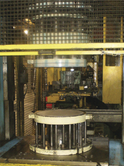

Each production line features a 250- to 400-ton AP&T hydraulic press with varying degrees of automation. Draws reach 14 in. on blanks from 16.4- to 20.5-in. dia., of hot-rolled steel (HRb 40-70) 0.100 to 0.200 in. thick. Four of the press lines are fed blanks manually by Bristol operators, the other four are robotically loaded with AP&T press robots. Cycle time in the press is 10 to 11 sec.—an initial first draw followed by a redraw to resize and reconfigure the part. Capacity is 14,000 to 15,000 drawn parts per 24-hr. period across all eight lines. A conveyor carries the drawn parts route to a shear trimmer that trims the parts to specified height, to a piercing unit, and finally to a wash station.

One of eight draw-redraw lines at Bristol Compressors prepares to form a blank into a compressor housing; press cycle time is 10 to 11 sec.

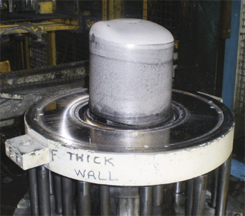

A drawn compressor housing is ready for post-processing—a conveyor will carry the drawn part to a shear trimmer, a piercing unit and then to a wash station.

“Not only are we holding the tight fitup tolerances required for welding the housings,” says Counts, “but we’re also more than quadrupling draw-ring life, running our draw rings for as long as 3 yr. This is due in part to the consistency of the dry-lube coating, as well as recent change in draw-ring radius. We went to a longer, softer radius on the rings to prevent the lube from being wiped off during the forming process. MF
