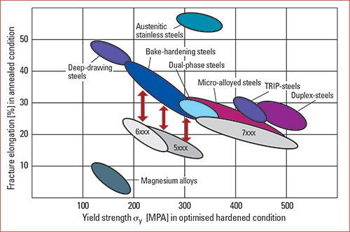

High-strength aluminum presents some of the same ductility and springback problems as HSS, along with higher costs, McClure says. These factors had been holding back the use of aluminum, but now that manufacturers are moving toward higher-strength materials, there is less of a barrier to using aluminum.
material trends—HSS and LW
Fig. 2—Many vehicle manufacturers are incorporating more HSS and aluminum into their vehicle frames.
(Figure courtesy of Houghton International)
