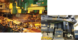

The group incorporated several useful innovations that improved operations and reduced waste. The lubricant is automatically mixed in a central system and pumped to spray manifolds at each press. The manifolds feed spray nozzles hard-plumbed into each die. Each nozzle, individually programmed per job, strategically applies the lubricant to the appropriate area of a blank or stamped section. Color-coded tubing ensures that the properly programmed line is attached to the correct nozzle. With each job programmed into the central press PLC, the appropriate lube program automatically transfers.
This system provides several improvements that reduce scrap, improve tool life, and minimize lubricant use. Hard-plumbed and programmed nozzles ensure that the right amount of lubricant is applied in the right area from the first hit. Particularly with high-strength steels, a tool can be damaged in one hit if the lubricant mixture is wrong or is applied in the wrong place.
Martinrea’s system minimizes the risk of a sprayer being displaced or improperly aimed. Programmable spray nozzles also allow the plant to strategically apply the lubricant. The program has provided significant reductions in utility use, waste and wastewater disposal, potential scrap reduction and safety issues. The new lubricant operates at a lighter viscosity and allows the spray system to provide a crisp spray pattern that shuts off without dribbling.
