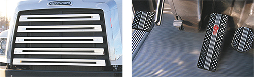

RealWheels uses its new laser cutter for 85 percent of its products, including Freightliner grilles (left) and Kenworth billet pedals (right

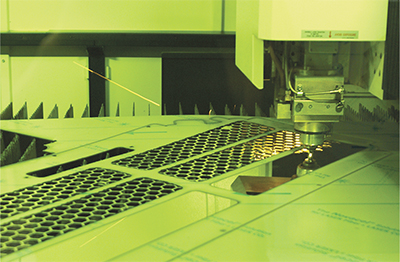

Checking off its list of requirements, RealWheels selected the Optiplex Nexus 3015 fiber laser-cutting machine from Mazak Optonics Corp., Elgin, IL. The machine, installed this past March, offers a side door for simple internal access, pallet changer to increase throughput, ball transfer to keep stainless steel scratch-free and Mazak’s multi-function torch.
Key to the entire package are the machine’s Intelligent setup and monitoring functions. Automatic setup functions include nozzle changing, focus position, focus detection, profiler calibration and nozzle cleaning. Monitoring functions include pierce, plasma and burn detection. Together, these capabilities dramatically simplify operation and automatically adjust cutting parameters to increase the quality of parts and overall throughput, according to Mazak officials.

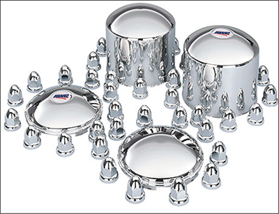

In the early-1980s, RealWheels started out making custom wheel covers. Wheel work, including this stainless-steel wheel-trim kit with lug-nut covers, is still a mainstay of the business.
