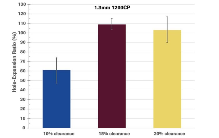

To quantify a material’s edge-stretching ability, we call on the hole-expansion test. After creating a hole of known diameter, a punch with specific dimensions expands that hole until an edge crack ends the test. The hole-expansion ratio represents the percent expansion of the initial hole diameter.
The international standard ISO 16630, “Metallic materials—Sheet and strip—Hole expanding test,” specifies several test parameters, including a 10-mm initial hole diameter created by shearing with a 12-percent clearance, and expanded with a conical punch with a 60-deg. apex angle. Locking in these values creates a way to compare performance between grades and suppliers. Larger initial-hole diameter appears to be associated with reduced hole expansion, and 12-percent clearance may not be the best choice to optimize edge stretchability.
For nearly 50 years, practitioners have known that a machined hole results in the best hole expansion—as much as three times that of a hole punched with 10-percent clearance. This results from the lack of a work-hardened shear-affected zone around the hole circumference. Other approaches that result in minimal edge work hardening, such as laser or waterjet cutting, also fall into this category. However, this information is difficult to put into practice, since punching holes remain the standard approach used in high-volume operations.
Historically, 10-percent punch-to-die clearance has been the rule of thumb used throughout the world. For mild and HSLA steels, this produces sufficient results since these grades have decent edge stretchability. With AHSS grades, however, the influence of punching clearance deserves greater attention.
Researchers have determined that thicker steels require greater clearance, with some recommending an extra 1-percent clearance for each additional 0.5 mm in thickness. Other sources suggest that optimized performance occurs at 15- to 18-percent clearance, depending on the strength, thickness and microstructure. For example, Fig. 3 highlights the effect of cutting clearance on a CP steel with 1200-MPa tensile strength and reinforces that the historical rule-of-thumb guidance of 10-percent clearance does not apply for all grades. Increasing the clearance to 15 percent leads to a significant improvement in hole expansion. And while the HER resulting from a 20-percent clearance was substantially better than that from a 10-percent clearance, it was not as good as from a 15-percent clearance. Importantly, these differences do not appear when testing only to the requirements of ISO 16630, which specifies the use of 12-percent clearance.
