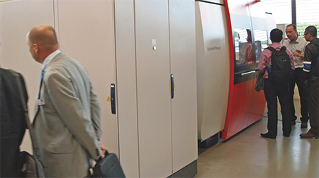

Bystronic Competence Days visitors take a look at the large-format BySprint Pro 4020, with a 4400-W laser source and 2- by 4-m table. |
