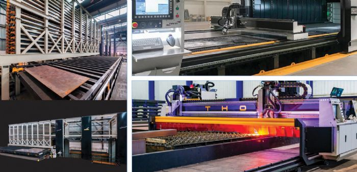

Tecoi USA showcases its total system solution, featuring large-format plate-processing machines that integrate machining combined with StockTec automated material handling. The large-format Thor (Tecoi Hyper Operative Range) plate-processing machine integrates plasma cutting and a beveling system with oxyfuel cutting. It also integrates mechanical cutting, including milling, drilling, tapping, countersinking, marking, etc.
Tecoi’s LS-series laser and drilling machine incorporates the choice of either one or two drilling heads, maximizing its large-dimension laser-processing and cutting-station capabilities. Each drill head includes as many as six tools, with 22-hp 4000-rpm machining power per head, drilling to 22 mm and tapping to M16, and tool change that can be accomplished in seconds.
For optimal productivity, Tecoi integrates StockTec, an automated plate-storage and -processing system. The independent tray system stores and dispenses materials immediately based on production needs.
