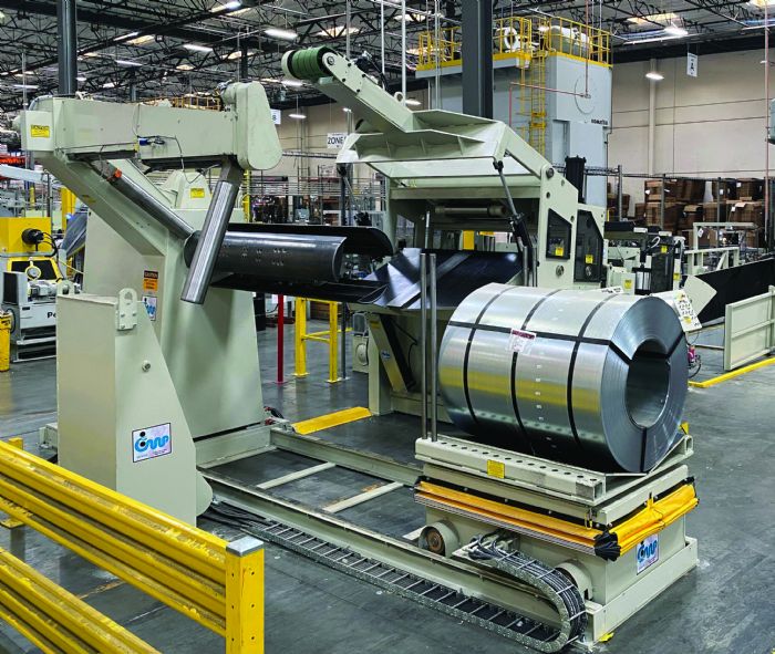

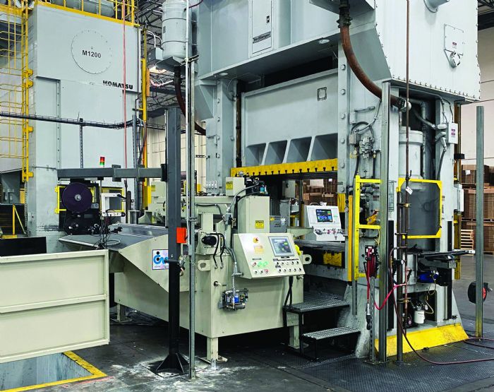

The company decided on installing three nearly identical, 36-in.-wide servo-driven press-feed lines, paired with new Komatsu two-point H2W 200-H (high-speed) servo presses. Each feed line comprises a 20,000-lb.-capacity uncoiler with accompanying coil car, a powered straightener with a hold-down peeler station on the entry end to facilitate hands-free threading and a Unist stock-lubrication system.
The two-roll servo feed lines were engineered for maximum automation with Allen/Bradley Kinetix controls and Compact Logix PLC—a “total system control,” according to Formtek-Maine officials. The system positions a color touchscreen HMI at the feeder control console and a second touchscreen at the straightener control panel to control the back of the line: the straightener, hold-down peeler station, threading tables, uncoiler, and coil car. With this control, an operator can thread a coil in 5 min. and set up the entire feed line in less than 1 min.
The Formtek-Maine ServoMax feed-control program allows operators to set all powered features of the line automatically upon recall of a job number. It has storage capacity for as many as 200 jobs, detailing the standard values of length, batch size, and speed settings from 1 to 10, as well as additional settings for coil width, coil OD, material thickness and passline height.
The powered feed cabinet adjusts to the correct passline height. Edge guides at the feeder and straightener and the roller coil keepers on the uncoiler traverse to match the coil’s pre-programmed width. Upper straightener rolls move to the correct positions to straighten the material thickness stored under that job number. A barcode scanner can be used to scan barcodes on the labels of incoming coils and call up the job associated with that coil barcode.
The straightener touchscreen includes a host of on-screen functions. Digital roll-position readouts for the upper straightener-roll settings facilitate threadup of a new coil. Diagnostic fault messages with recommended remedies automatically appear on screen to warn the operator of an error and how to correct the problem.
The operator has access to on-screen step-by-step threadup instructions with illustrations, enabling new operators unfamiliar with the equipment to thread the line easily. Maintenance screens with diagrams facilitate troubleshooting and include manual lubrication points highlighted for ease of maintenance. The timers for the automatic lubrication pumps can be set on the screen as well. And, on-screen parts diagrams for each machine, the hydraulic and pneumatic schematics, and the electrical prints provide part numbers for each item for quick and easy part identification in a breakdown situation.
