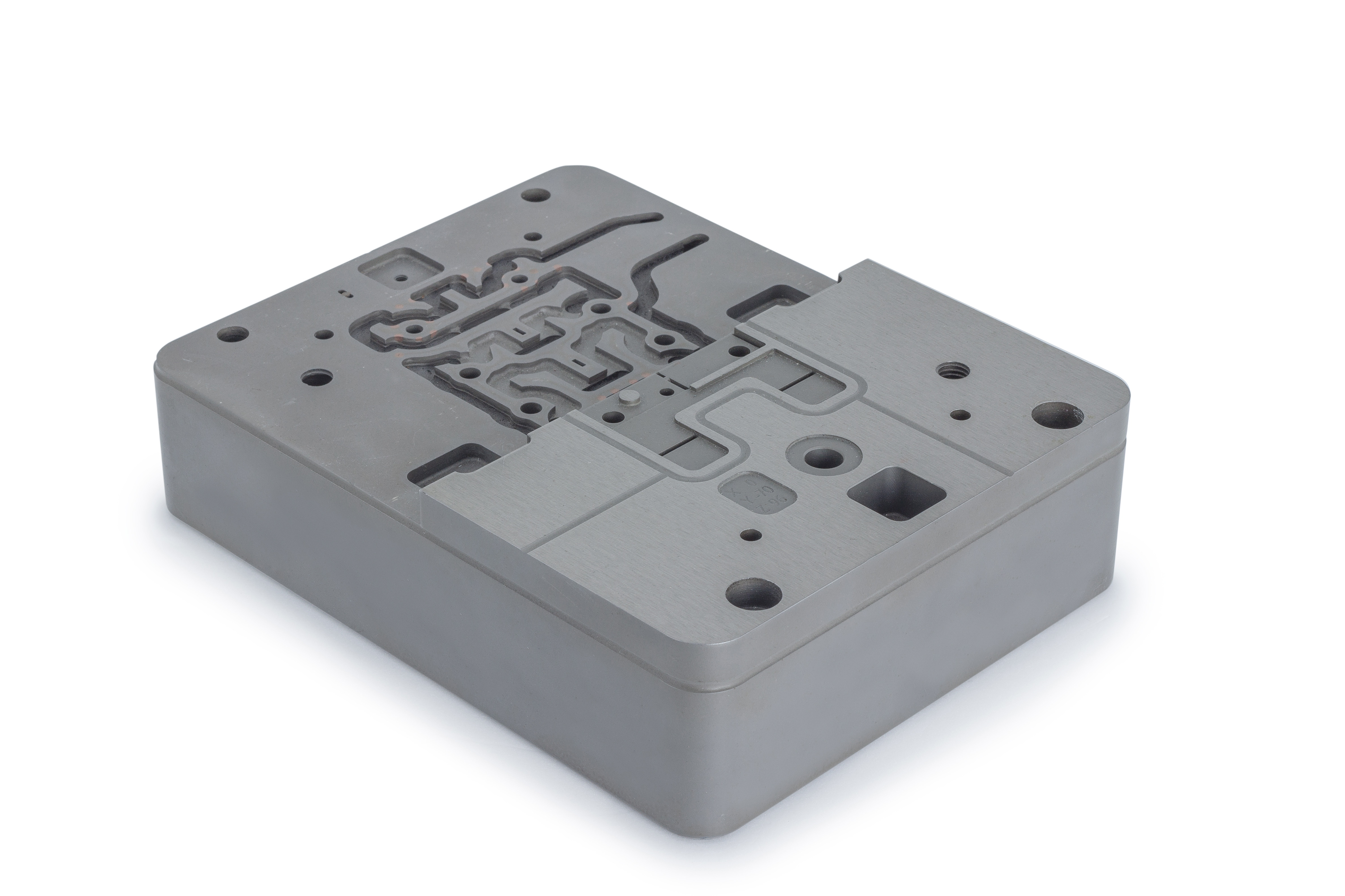

A unique additive manufacturing (AM) process is helping precision machine shops create metal parts with complex internal cooling passageways or channels for dispsensing liquids or gases, layer by layer using the diffusion bonding process, before final machining. And, as with similar techniques, 3D modeling software maps out the sophisticated internal channels or passageways prior to laser cutting of each layer.
Diffiusion bonding fuses the combined layers of metal-alloy sheet under pressure and heat, without the need for brazing or other filler material. When used for AM, the manufacturing process—called laminated-object manufacturing (LOM)—joins thin metal sheets (approximately 1 to 2 mm thick). The layered sheets then are laser cut so that when combined, they create internal passageways. The final layered part then can be machined using traditional CNC turning and milling equipment as needed, to bring the exterior of the part to its final shape.
Laminated object manufacturing—a metal-AM process that uses diffusion bonding to layer metal-alloy sheets—finds use in fabricating plastic injection molds with conformal-cooling channels.
Using LOM, shops can create finished parts as large as 900 by 1250 by 500 mm, from stainless steel, titanium, zirconium, beryllium, high-alloyed aluminum, Inconel and tungsten alloys. The process also can fuse dissimilar metal alloys, such as copper to titanium, aluminum, or tungsten, and even molybdenum to aluminum.

Diffusion bonding, on the other hand, creates a superior bond without the need for filler material. During diffusion bonding, high temperature and pressure applied to the workpieces cause the atoms on solid metallic surfaces to intersperse and bond. Unlike traditional brazing techniques, the resulting bond exhibits the strength and temperature resistance of the base materials.
For the atoms of two solid, metallic surfaces to intersperse, they typically must be at 50 to 70 percent of their absolute melting temperature. To achieve these temperatures, the workpiece surfaces are heated—either in a furnace or by electrical resistance—to temperatures as high as 1400 C.
Shops have employed this technique for many years to join high-strength and refractory metals that prove difficult or impossible to weld by other means. However, recent improvements in diffusion-bonding presses have made the process even more attractive. For example, new multi-cylinder hydraulic presses boast improved capabilities over single-cylinder presses that require fixtures to apply a consistent, measurable amount of force—a key factor in the process.
By independently controlling each cylinder, a multi-cylinder press can provide extremely consistent pressure across the entire surface of the workpiece. In some cases, built-in pressure transducers along the bottom of the pressing plate allow for the adjustment of individual hydraulic cylinders, resulting in precise pressure uniformity over large areas.
