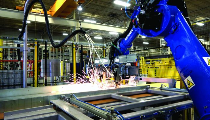

Workplace accidents have a devastating impact, both on the individuals involved and the company. Many types of safety systems can protect operators from being injured by hazards present in machinery, but the most robust method: removing the operator from the hazard. By implementing robotics in the automation of RW applications, the operator need not access the machine during normal operation.
Robots can operate safely within a hard-guarded perimeter without the need for human interaction, and integrate into safety and e-stop systems. Safety solutions may be as simple as an e-stop button that stops the robot, and a safety door that only allows the robot to be manually moved at a safe speed for teaching. More-complex safety circuits only allow the robot to operate within safe zones while other areas are being accessed.
