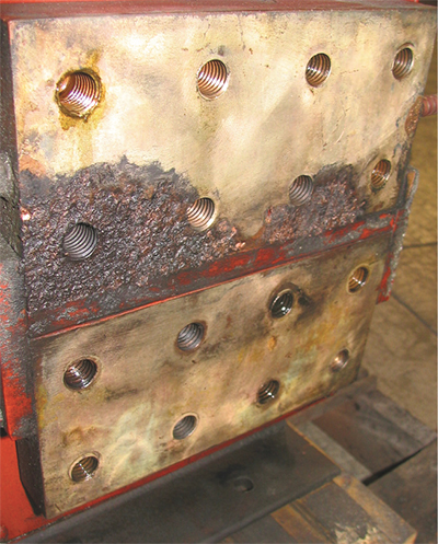

Remaching surfaces may be required to restore full power to the welding machine
Fig. 1—Remachining surfaces may be required to restore full power to the welding machine.

Corrosion had built up in this welder’s secondary electrical connections due to many years of neglect. The added resistance eventually prevented the proper flow of welding current from the transformer through the machine’s secondary circuit and to the spot-welding tips. With the welding current output typically transmitted from the transformer to the part at only 6 to 8 V, almost any resistance in the circuit is too much.
As a nonengineer, I always think of a resistance welding machine’s ability to deliver welding amps in terms of a garden hose. Secondary voltage operates like water pressure and pushes the welding amps out to the tips. Similarly, water volume is like welding amps in that more pressure equals more flow. Continuing our garden-hose analogy, a kink in the hose will restrict or completely cut off the flow.
Causes of current-flow problems include loose connections, oxidation, dirt, grease and other contamination. In addition, as the secondary circuit deteriorates and generates more resistance and heat, it feeds on itself and accelerates the problem.
Loose connections are common and eventually will lead to arcing between the mating copper surfaces, which causes pitting, reduces the contact area and limits welding current. Remachining these surfaces may be required to restore the welding machine to full power. (Fig. 1)
We recommend breaking down a machine’s secondary electrical connections at least once per year for cleaning and polishing. Some users even silver plate the connections to improve conductivity.
