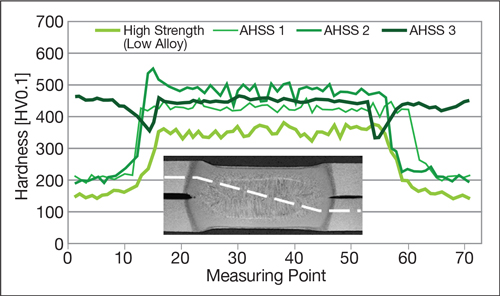

Fig. 3—Microhardness traverses of spot welds reveal much higher hardness values for AHSS compared to conventional high-strength low-alloy steels. Source: WorldAutoSteel
Note: While many CE formulas find use for evaluating AHSS grades, their use and accuracy are not nearly as well established as they are for conventional steels. But regardless of the formula used, CEs for AHSS grades likely will exceed those for conventional steels, likely causing the formation of hard martensite during RSW.
For example, the WorldAutoSteel organization used a CE formula called the Yurioka Equation to determine the CEs of some TRIP and DP steels (in the range of 1000-MPa tensile strength). These steels approached CEs of 0.6 –extremely high when compared to that for high-strength low-alloy steels (Fig. 3).
