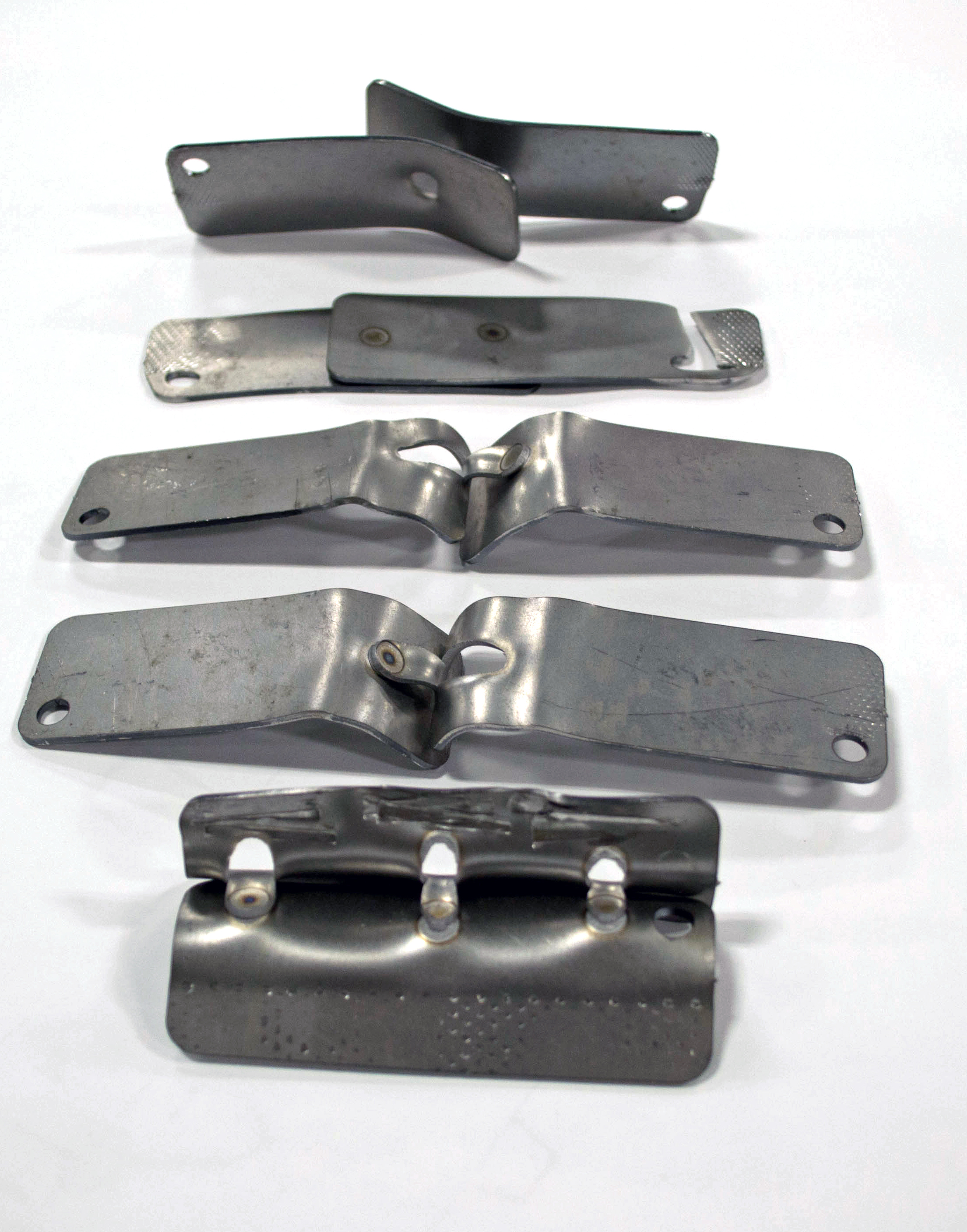

The RSW process looks simple, but fabricators must understand well, and control, the process variables in order to achieve the desired results: a weld stronger than the parent material (illustrated here by a series of pull-test samples).

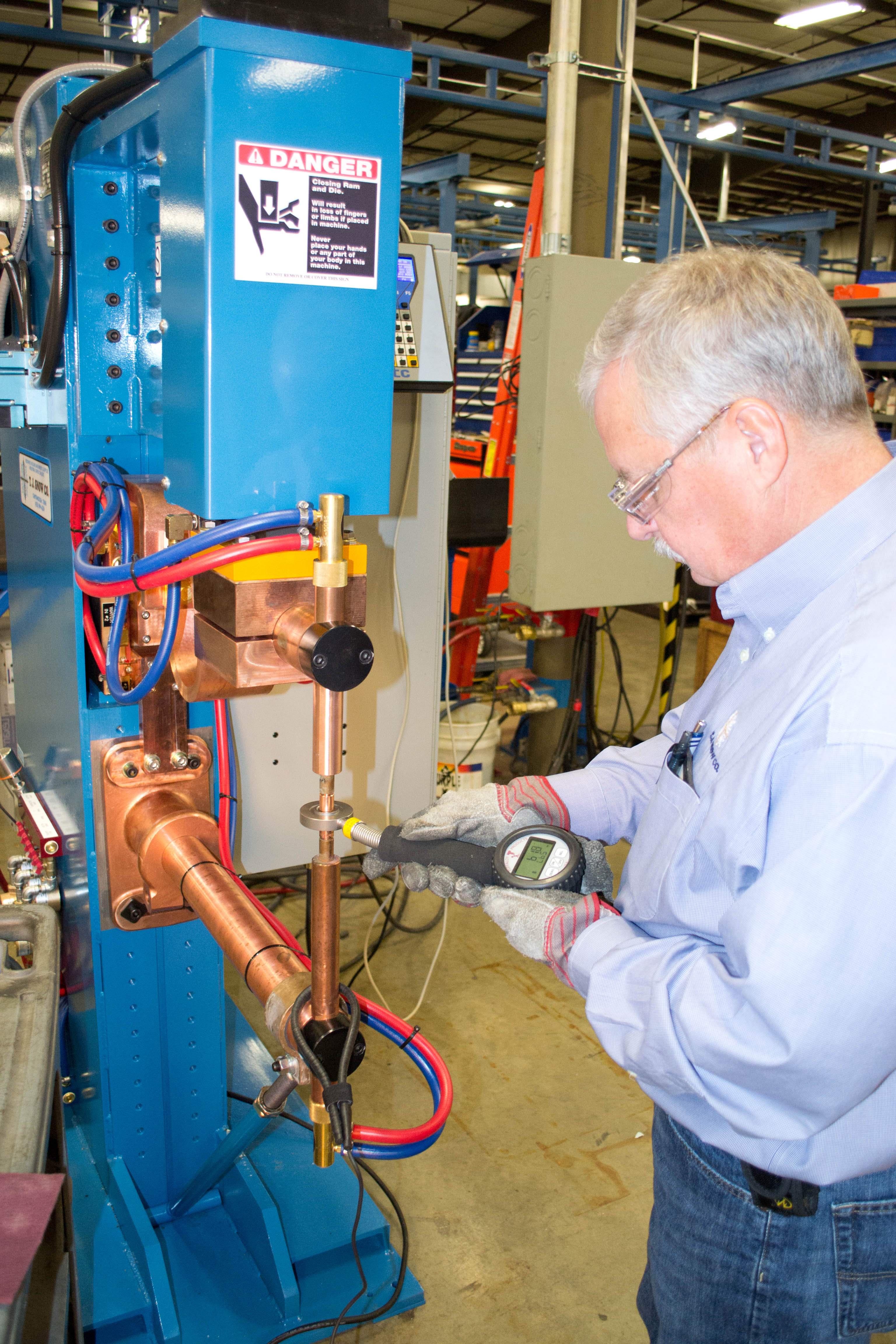

For example, when welding two pieces of 18-gauge low-carbon steel, the recommended machine settings are 660 lb. of pressure, 9600 secondary amps and eight cycles of weld time. (Note: Since most RSW machines do not display these variables, fabricators should use a weld monitor that displays weld current and time, and an electrode-force gauge during machine setup).
Long weld times often are used when trying to correct a problem with weld-joint strength. However, if your weld times are too long, that variable is not in the correct “portion” to weld the material, according to the PCT recipe for the workpiece material.
Since most RSW machines do not display the critical process variables, fabricators should use an external amperage meter and force gauge during machine setup.

Getting back to our customer who believed that an extremely long weld time was the answer to producing strong spot welds, we proved through destructive testing that only eight cycles of weld time would produce a much stronger weld joint than the 73 cycles of weld time being used prior to our arrival.
In fact, while the “over-baked” assembly broke apart easily when hammered, our properly welded part never did break despite the operator’s best efforts to prove us wrong. We left the customer happy and confident in the RSW process, optimized with a shorter weld time that increased his production rate; produced consistently high-quality welds; and improved welding-electrode life. MF
