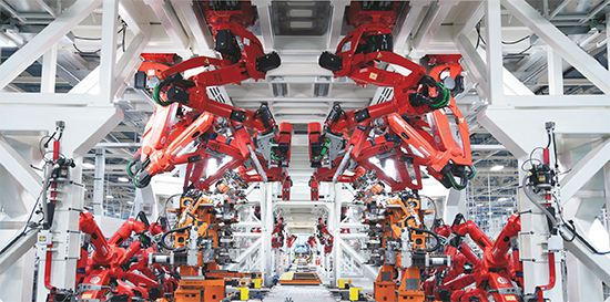

robotic resistance-welding line stars at Chrysler's Sterling Heights, MI, facility.
This robotic resistance-welding line stars at Chrysler’s Sterling Heights, MI, facility, assembling the 2015 Chrysler 200 body-in-white. The high-strength-steel-intensive structure comprises 30 percent advanced high-strength steels (550-780 MPa tensile strength). It’s in the roof rail, B-pillar and rocker panels. Another 10 percent is either ultra-high-strength (above 780 MPa tensile strength) or hot-stamped steel (1000 MPa and above). Hot-stamped parts are in the A- and B-pillars, the roof header and the door ring.

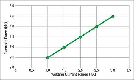

Current range for varying electrode force for RSW of AHSS
Fig. 1—Current range for varying electrode force for RSW of AHSS. Electrode cap Type B 16/6, 6-mm-dia. tip, single pulse, 340-msec weld time, 250-msec hold time.

AHSS often have tighter weld windows (welding parameters that give acceptable welds) when compared to mild steels. The process window for RSW of AHSS is influenced by several parameters, including electrode force and welding time. Investigation by a steel producer has found that the acceptable range of welding current increases by an average of 500 A for every additional 500 N of electrode force (Fig. 1). The current range also increases by an average of 250 A for each additional 40 msec of welding time (Fig. 2). Extra amounts of electrode force and welding time lead to increased current range, allowing for a wider process window.

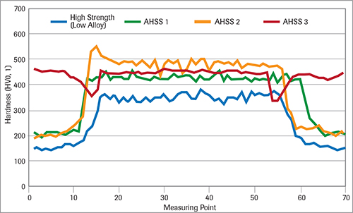

Hardness distribution through spot welds on various grades of AHSS
 Fig. 3—Hardness distribution through spot welds on various grades of AHSS.
Again, all three DP steels had similar weld-hardness distributions (Fig. 3). The study also concluded that weld fracture mode alone is not a good indicator of weld integrity and performance. The load to fracture should be considered more important in judging weld integrity.

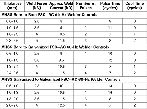

Heat input must be changed depending on the steel thickness and grade. Compared to lower-strength steel at a particular gauge, an AHSS grade at the same gauge may need less current. Similarly, the thin-gauge material needs less current than thick gauge. Controlling heat input during RSW according to the gauge and grade is called heat balance.
Understanding Heat Balance and Electrode Life
Weld schedules for RSW of bare and galvanized AHSS
 Weld schedules for RSW of bare and galvanized AHSS.
For a particular steel grade, changes in thickness may require adoption of special weld schedules to control heat balance. Due to the higher resistivity of AHSS, weld-nugget growth occurs preferentially in AHSS. Electrode life on the AHSS side may be reduced due to higher temperature resulting from high bulk resistance and high material stiffness. In general, electrode life when welding AHSS may be similar to mild steel because of the lower operating-current requirement due to higher bulk resistivity in AHSS. This increase in electrode life may be offset in production due to poor part fitup created by higher AHSS springback. As electrodes wear, tip diameter increases, which then requires an increase in welding current and electrode force. Also, frequent tip dressing will maintain the electrode-tip shape and help achieve consistently acceptable welds.

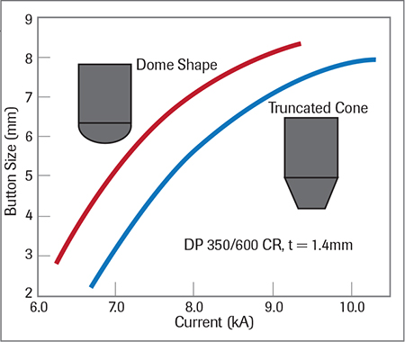

Effect of weldng-electrode geometry on current range when using AC power mode and a single pulse
Fig. 4—Effect of welding-electrode geometry on current range when using AC power mode and a single pulse.
AHSS can be welded with all weld-tip shapes (truncated cone and dome) and materials (Fig. 4). Dome-shaped electrodes ensure sufficient buttons even at lower currents due to higher current densities at the center of the dome shape. The curve of dome-shaped electrodes will help to decrease the effect of electrode misalignment. However, dome electrodes might have less electrode life on coated steels without frequent tip dressing. Due to round edges, the dome electrode will have fewer tendencies to develop surface cracks when compared to a truncated electrode.
