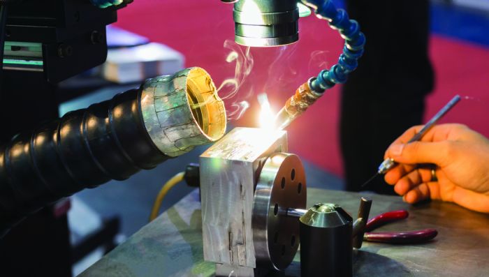

Robotic laser welders may contain fumes under a hood. Alternatively, a fume arm or intake plenum may be positioned to pull fume away from the weld seam. For manual laser welding, a fume arm or backdraft table should be used to pull fumes away from the welder. The right solution depends on the size of the assembly being welded and the mobility of the welding arm, among other factors. Minimizing the amount of air that must be moved for efficient capture of fumes will reduce system energy consumption and operating costs.

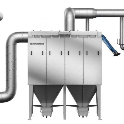

Dust-Collector Type and Sizing
Cartridge-style dust collectors prove ideal for collection of fumes from laser cutting or welding. Cartridge collectors come in many sizes, from small portable units that can support a single cutting machine or welding cell to large units ducted to multiple machines or cells throughout a facility. These collectors, highly versatile for machining and metalworking applications, offer higher energy efficiency and lower physical footprints than baghouse-style collectors of similar airflow. Cartridges are available in a range of media types and efficiency ratings, making them suitable for collection of different dust types, ranging from submicron particulate to coarse, abrasive dust encountered in grinding and finishing processes.
The dust collector must be sized properly for the volume of dust produced and the amount of airflow required for collection. Two main factors affect sizing:
1. Airflow. The collector must have enough airflow, measured as ft.3/min (CFM), to maintain the required capture velocities for the volume of air that must be moved. Efficient hood design will minimize CFM requirements.
2. Air-to-cloth ratio. The collector must have sufficient filter media for the volume of air being moved and the amount of particulate generated. The heavier the particulate load, the more filter media needed per CFM—a lower air-to-cloth ratio. In general, laser cutting applications will require a lower air-to-cloth ratio than laser welding, with ratios typically between 1:1 and 0.5: 1, or 1 to 2 ft. of filter media for each CFM of air. An excessive air-to-cloth ratio will cause filters to load too quickly, requiring more-frequent replacement.
