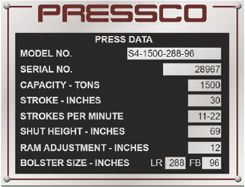

The press shut height can be found on a specification plate attached to the press frame (Fig. 2) and in the presses’ technical manuals. Shut height may be expressed in inches, metric units or both.
The press shut height listed on the specification plate is its maximum height. The ram has an adjustment screw that can be turned manually or by an electric motor to adjust the ram position downward to reduce the press shut height. The maximum amount of adjustment is determined by the adjustment-screw length. The maximum adjustment also is listed on the press-specification plate.

Fig. 2—Press data specification plate
Die height is defined as the distance from the bottom face of the ram to the top of the bolster, with the ram positioned at the very bottom of its stroke. Calculate maximum die height by subtracting the bolster thickness from the press shut height. To obtain minimum die height, subtract the ram-adjustment length from the maximum die-height distance.
