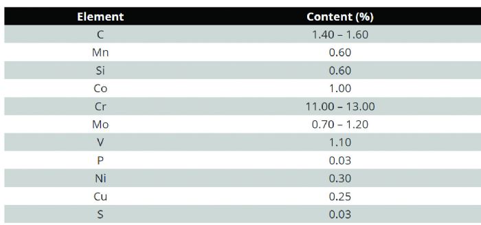

D2-Composition-Ulintz-Tooling-By-Design-MetalForming-MagazineThe patent makes several claims related to composition, including “an alloy steel containing carbon about 1.4 to 1.6%, chromium about 11.5 to 12.5%, vanadium about 0.75 to 1.25%, molybdenum about 0.75 to 1.25%, and having the capability for air hardening even in fairly large sections to over 600 Brinell and the capability for being annealed to a softness below 210 Brinell.”
American Iron and Steel Institute (AISI) designations for cold-work tool steels did not exist at the time of Comstock’s patent submission, thus no reference to D2 in the patent document. However, the chemical-composition range listed in the patent matches that of commercially available D2 steel (Fig. 2). A single value listed for elements denotes the maximum allowable percentage.
Finally, the patent claims air hardenability exceeding 600 BHN—the typical upper hardness range for D2—and annealing to 210 BHN or less, if desired. The delivery condition for AISI D2: approximately 210 BHN.
