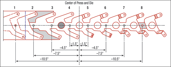

The strip layout in the accompanying illustration represents a process for an eight-station progressive die. To calculate the tipping moments, multiply the cutting and forming forces by the distance from the center of the press where the forces act. Using the center of the press as the origin, distances to the left would have negative values while the distances to right would be positive. In a perfect world, the sum of all of the moments would equal zero, indicating balanced forces across the press slide.
Table 1 quantifies the cutting and forming forces for each die station, and the distance from the center of the press where those forces act. The last column in the table shows the resultant moments at each die station. Here, the sum of all of the moments equals –121.5 in.-tons, indicating an unbalanced load across the slide.

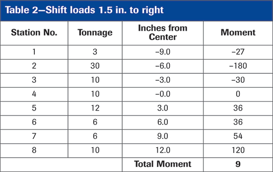

For example, shifting the strip layout in the above illustration to the right 1.5 in. would position the pilot hole at station four on the centerline of the press. This would substantially reduce the resulting moments (Table 2).

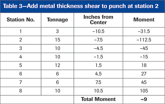

Shifting the die strip would require that the die slightly increase in length. If this is not possible due to limited press-bed space, strategically applying shear to select cutting punches would help balance the loads. For example, adding metal thickness shear to the cutting punch in station two reduces cutting force by approximately 50 percent (Table 3), balancing the loads across the press slide. Another benefit of the punch shear: reduced impact load, shock and vibration.
