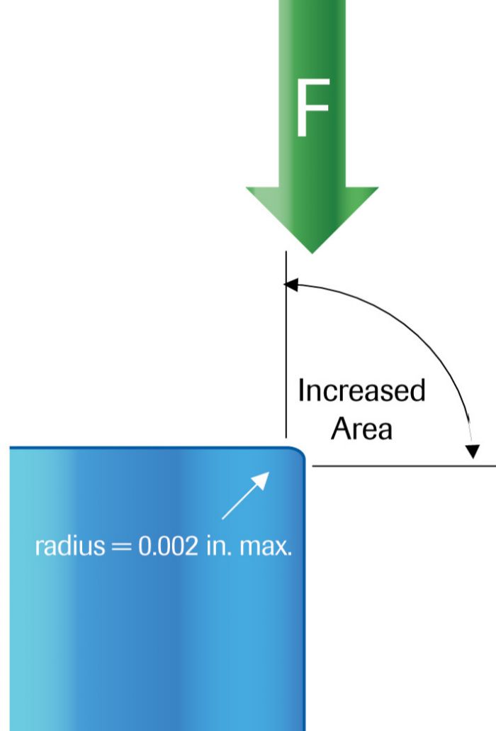

Design Fig. 2Besides increasing cutting clearances, another method to reduce edge chipping: Add a very small radius to the punch edge (Fig. 1). Accomplish this with a single light pass over the cutting edge using a hand-held India oilstone. The result: a 0.001 to 0.002-in. radius that helps to reduce edge stress.
Stress is a measure of an external force acting over the cross-sectional area of an object (Fig. 2). Generally, the cutting force (F) is similar with or without a small radius, but the additional surface area of a small radius reduces edge stress.
