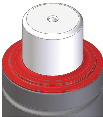

A secondary wiper, as shown here, can be installed on a cylinder to help ward off fluids.

Dies often operate in a fluid-filled environment, with liquids applied to tooling and parts and other oils and fluids used in machine components. Deep-draw operations, for example, may require flooding the die with lubricant. Despite efforts to seal nitrogen-gas cylinders, over time fluid may seep into a cylinder.
“Fluids in the cylinder can wreak havoc on the wiper and the seal, and caustic lubricants can cause premature spring failure,” explains Glynn.
In addition, fluids seeping into a cylinder reduce cylinder volume, thus overpressurizing the cylinder. To help combat fluid in cylinders, Glynn suggests taking steps such as installing drain holes in spring pockets.
Some spring manufacturers, including Special Springs, offer products to help. For example, secondary wipers can be installed on a cylinder, as can covers that attach to a spring’s piston rod, to help ward off fluids. One safety feature, referred to as overpressure active safety, will release gas if a cylinder becomes overpressurized. MF
