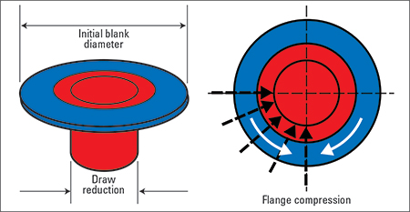

Fig. 1—Flange compression in a draw reduction.
Fig. 1 illustrates what happens when a round blank is drawn into a cylindrical cup. As the blank is drawn into the die cavity, the remaining material (flange) is compressed in the circumferential direction. As a result, large in-plane stresses build in the flange, which if not properly controlled can cause the blank to buckle or wrinkle.
A blankholder is used to control material flow by applying a restraining force to the blank surface. The blankholder must provide sufficient force to prevent buckles and wrinkle formation, but still allow the blank to flow toward the die cavity. If blankholder forces are set too high, excessive stretching and thinning can result, causing the material to rip, tear or split.

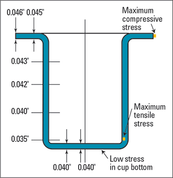

Fig. 2—Thickness distributions in a drawn cup.

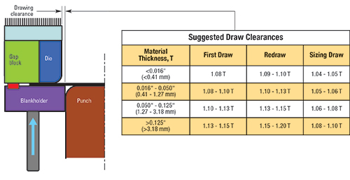

The problem of excessive blank-holder pressure can be remedied by using adjustable gap blocks, also referred to as stand-offs. Gap blocks allows higher blankholding forces without restricting material flow by providing a constant gap between the die face and the blankholder. Gap blocks are initially set at material thickness plus an additional 10 percent to accommodate material thickening due to constancy of volume in the blank.

The cross-section in Fig. 2 depicts a distinct pattern of thickening and thinning found in flat-bottom-cup drawing. Large compressive stresses are found in the flange where the material has thickened considerably. In the cup wall, which was formed by a combination of compressive and tensile stresses, the amount of thickening diminishes as it approaches the die-impact (shock) line. Below this line, thinning is observed, as the maximum tensile stress occurs near the punch-nose radius. The small punch-nose radius, as shown, concentrates the maximum tensile stress near the cup bottom, where little or no deformation has occurred. Deeper draws are possible when larger punch-nose radii are employed because the larger radius shifts the maximum-tensile-stress site farther down the cup wall, where the material has been strengthened by coldworking. No deformation takes place at the flat cup bottom; thus, the material retains its original thickness in this location.
Fig. 3 provides recommended tooling clearances for deep-drawn cups of low-carbon steels. Having studied the anatomy of a deep-drawn cup, it becomes clear why these tooling clearances, gap blocks and larger radii are required in successful deep-drawing tools. MF
