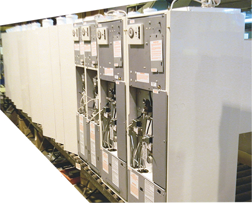

Johnson & Starley Ltd. manufactures energy-efficient heating and ventilation equipment. Sheetmetal panels, the majority 0.9- and 1.2-mm mild steel, are punched using semi-shearing, hole-punching and embossing tools.

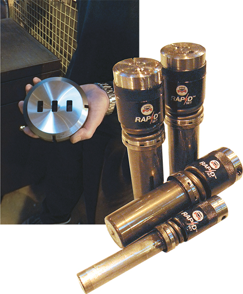

J&S employs its new tool-sharpening system to return dies and punches to near-new condition. Shown are the Mate cluster die and Rapidset (adjustable punch length) tools used in the firm’s sheetmetal-fabrication shop.

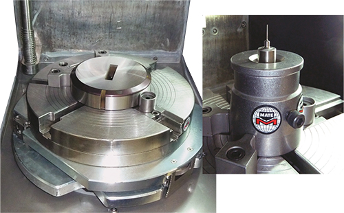

Premia tool-sharpening machine
J&S’s Premia tool-sharpening machine handles large station dies (left) as well as small-diameter punches (right).
Using the Premia, a typical tool-sharpening process at J&S has been reduced from an average of 25 min. to just a couple of minutes.
“And, we have been really surprised to find that the quality of the sharpened finish is nearly equal to that of new tools,” adds Yates. “Compared to using a surface grinder on the tools, quality is improved by as much as 50 percent.”
The new tool-sharpening system has eliminated burrs on part edges, and the Premia system accommodates even the smallest punches without danger of breakage—a problem previously experienced at J&S.

Operating the sharpening machine, an operator mounts the tool in a universal fixture that accommodates all popular tooling styles. Essentially, all he needs to do is insert the tool in the fixture, select the appropriate program from the menu and press the start button.
