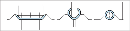

Forming a curl on an electrical terminal
Fig. 2—Forming a curl on an electrical terminal.

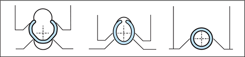

Die closing sequence for last curl station
Fig. 3—Die-closing sequence for last curl station.

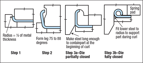

Forming a curl on a hinge plate
Fig. 4—Forming a curl on a hinge plate.

Fig. 2 illustrates the forming sequence to process a terminal part from flat sheetmetal into a cylindrical shape. The first form station begins the curl—or nip—process on both ends, usually 75 to 88 deg.
The second form station forms the center into a V shape. The objective is to form as steep a V as the first form and punch width. Forming with a radius slightly less than half of the inside diameter will allow for easier nesting into the last form station, and generate a round part.
The third station is the final curling station. It completes the forming of a cylindrical tube without the benefit of an arbor in the inside diameter. Fig. 3 illustrates the closing sequence of the curling station from initial punch contact on the preformed shape to the final sizing of the outside diameter.
The outside diameter sizing is effective only if the ends butt together and force the material outward into the round circle that the closed die forms at the bottom of the press stroke.
The length of the flat blank is critical for success. Any inaccuracy in the calculation gets multiplied by a factor of four for 360 deg. of bending. If the precut blank is too long, the form tool will not close properly on the part and distortion of the cylinder will result at the bottom of the press stroke. If the blank is too short, the ends will not fill the entire circle in the tooling, and no outward push will occur. This means the part will not be round and a gap may result between the ends.
With proper blank development, roundness and accuracy of the part can be reasonably controlled with this process. If the inside diameter requires greater accuracy, a round pin on a cam could be inserted into the part prior to closure in the last form station. An air cylinder could suffice for insertion of an arbor and withdrawal after completion.
Another type of curl found on hinge plates features a similar number and type of forming steps to the electrical connector, but has a different tooling design because the curl is formed from one side only (Fig. 4).
