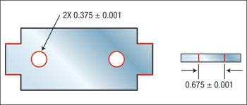

Question: I have a low-carbon steel part that is relatively thick—at least it is for us—at 0.125 in. It also has two holes and two tabs with tight tolerances (±0.001 in.). We would like to produce this part in a progressive die using shave operations rather than having it fineblanked. Unfortunately, shaving in a stamping die is something we have little experience with; could you provide us with some guidelines?
Answer: A simplified version of your stamping is shown in Fig. 1. The red areas depict those features that you wish to have shaved: two round holes and four straight edges.
Shave operations generally are associated with punched openings such as holes, but many free-edge features also can be shaved. In fact, most stamping applications requiring close tolerances on die-cut edges can be good candidates for shaving.
Here are some general guidelines for processing shaved features: First, let’s consider the 0.375-in.-dia. holes in Fig. 1. To achieve these diameters from a shave punch it will be necessary to punch the holes somewhat smaller than 0.375 in.; but how much smaller do we make them?
Close Shave Fig.1

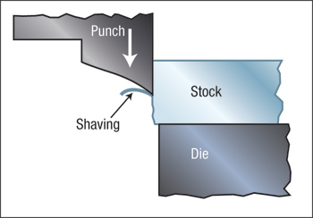

A close shave hollow ground concept
 Fig. 2—Hollow-Ground Concept
Proper shave clearance, on the other hand, will be very tight, usually 1 to 1.5 percent per side. Too much clearance results in a shear and “rebreaking” of the hole. In the example part, the proper shave punch appears to be 0.375-in. dia. However, when specifying shave punch diameters, remember that the resulting hole size will be slightly smaller than the actual punch size, usually by 0.0002 to 0.0004 in., due to elastic recovery after shaving. This means the shave punch in our example part should be ordered at 0.3753 in. dia. The corresponding die matrix should be 2 to 3 percent larger and have a ¼ in. land before transitioning into ½-deg. taper.
For very close tolerances, or when shaving very thick materials with pronounced die-break or taper, more than one shaving operation may be needed. When two shave steps are employed, the amount of material shaved in the second step should be one-half that of the first step. So if a total of 0.009 in. of material is to be shaved, 0.006 in. should be removed by the first shave punch and 0.003 in. removed by the second.
Since shaving is more of a machining operation (cutting) than a stamping operation (punching), a rake angle machined on the shave-punch face usually is necessary. This would be similar to the rake angle found on a cutting tool.
A close shave-fig. 3 close up view
 Fig. 3—Close-Up View
The “hollow-ground” shave punch concept is shown in Fig. 2 (courtesy of David Smith and Associates) and provides a cutting-tool action. This modification can improve surface-finish quality and extend punch life. Fig. 3 provides a close-up view of the concept.
Establishing the proper back-rake angle for each application is somewhat of a black art that requires trial-and-error development. Some brass and bronze alloys do not require any back angle at all; mild steels, depending on hardness, may require 20 to 30 deg.; some aluminum alloys may need as much as 45 deg.
