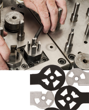

A change in tool coatings at Cowles Stamping increased punch life from 3000 to 16,000 hits between sharpenings when stamping HSLA-steel automotive parts.
Early in 2008, the firm found that when stamping parts for one automotive customer, its punches were breaking after only a few thousand hits. The problem: the punches were getting caught in the material. The solution: a switch to a new punch coating, which brought significantly longer punch life and increased productivity.

“After 3000 pieces, the punches—coated with a titanium-nitride product—actually pulled apart,” explains Cowles engineering manager Whyn Pelkey, describing difficulties experienced on an automotive part stamped on a progressive die in a 250-ton press at 35 strokes/min.
“The punches could not be sharpened due to the punch breakage,” recalls Steven Couture, Cowles manufacturing design engineer, noting that these types of punches, used to pierce holes, “are not conventionally restrained, but are taper-cut and then pressed into a holder.”
Problems occurred while stamping 0.157-in.-thick high-strength low-alloy steel (SAE-J1392 070XLF, 345-MPa yield strength) using the small, specially shaped punches with sharp corners.
Coating Success
“We suffered excessive premature punch failure,” says Pelkey. “Severe galling on the sides of the punches caused the punch ends to actually rip off as they would weld themselves into the material strip on the upstroke of the press. Over time (dating from the start of 2008) we tried various coatings with minimal or no success until we tried the FortiPhy Ultra Endurance chromium-nitride coating (from Phygen, Inc., Minneapolis, MN).”

Says Pelkey: “The coating allows us to produce an average of 16,000 stampings per run between sharpenings. And, we can resharpen the punches for continued life, which we could not do before.”
Thanks to the improved punch performance, Cowles now can complete a full part run without shutting down the press to remove the tooling and replace broken punches. That’s a huge timesaver, according to Pelkey, because the complicated tooling requires lengthy setup time. Broken punches used to cause six or seven stoppages per run.
“The FortiPhy-coated punches last for the whole run without the need for resharpening,” Pelkey says. “Producing a new punch consumes 9 hr. just on the wire-EDM machine, then a couple of days to send the punches out for coating. Essentially we would lose a week every time the punches broke. That does not happen now.
“Now, if needed, we can resharpen the punches,” Pelkey continues, “which takes just a few hours. But again, the punches last through an entire run, so we don’t have to stop the press and resharpen. This saves our company hours of downtime and the expense of replacing punches.”
Adds Couture: “The lubricity from the new coating has been spectacular. We no longer have problems with material catching the punches and breaking them.” MF
