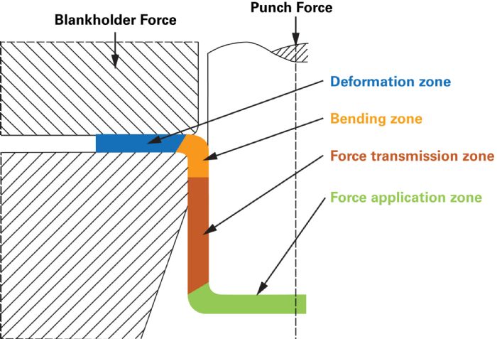

The principal characteristic of all deep drawing processes: indirect application of force. The force required to cause deformation is not applied directly to the deformation zone (flange area). Instead, a punch force acting on the blank causes the material to bend over the punch radius, where it reduces in thickness due to plane-strain bending. The stress at the bottom of the cup begins to transfer toward the cup diameter, creating the cup bottom. The force subsequently transmits from the cup bottom to the cup walls, then to the deformation zone (Fig. 1).
Fig 1We can divide the deep drawing process into six basic elements to better understand the mechanics.

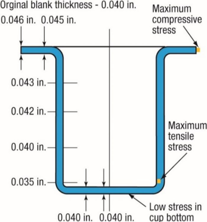

Fig. 2As the blank edge moves inward, it must reduce to a smaller circumference or perimeter. In the free state, the outer edge of the blank would reduce in length by buckling. Employing a blankholder to apply a holddown force forces the flange to thicken rather than buckle. A cross-section reveals a distinctive pattern of thickening and thinning found in flat-bottom cup drawing (Fig. 2).
Blank material located near the die radius at the start of the draw would experience little compression. The material located farther away undergoes more-significant compression, possibly causing it to move inward and flow over the die radius. This accounts for the variations in vertical wall thickness and the need for increased punch-to-die clearance in deep drawing.
Compressive loads cease after the sheet metal flows over the die radius.

Material in the cup wall, subject to tensile stress, deforms via plane-strain stretching, which results in sheet thinning near the radius. Maximum wall thickening occurs near the die-entry radius and diminishes as it approaches the die-impact, or shock, line. Thinning occurs below the die-impact line, with maximum tensile stress present near the punch-nose radius. A small punch-nose radius concentrates maximum tensile stress near the cup bottom where little or no deformation has occurred, increasing the likelihood of fracturing.

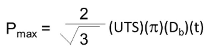

Failure near the cup bottom can relate to the ultimate tensile strength (UTS) of the material, the diameter of the blank (Db) and material thickness (t). Thus, the maximum punch load (Pmax) to fracture the cup bottom can be found using the following equation:
In practice, the actual drawing load and Pmax may measure very closely in magnitude. Deeper draws become possible when the punch-nose radius is larger because the site of maximum tensile stress moves further up the cup wall where the material has been strengthened by cold working.
