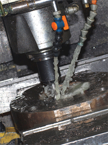

Fadal vertical-machining
A Fadal vertical-machining center makes quick work machining a die block in the Principal Mfg. toolroom.

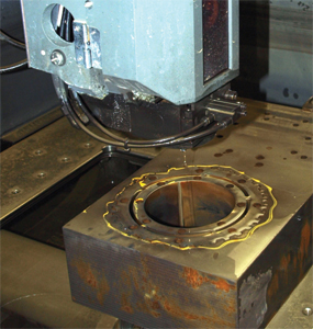

“We invested in new wire-EDM technology (a pair of Mitsubishi FA-20S machines) to increase capacity,” shares Brazzale. Comparing the new technology to old, he says that “we achieve the same surface finish on our die blocks and other machined components, but we get there 15 percent faster than we used to. For example, cutting a die block that once required five passes now takes only three. Our throughput has increased greatly, and hence so has our speed to market with new projects.”

Mewest machine from Mitsubishi
Wire-EDM work on the firm’s newest machines from Mitsubishi has become at least 15 percent more efficient thanks to state-of-the-art technology.

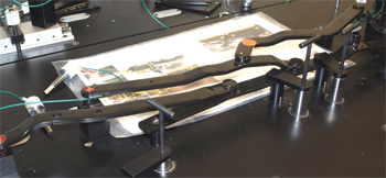

assembly room at Principal Mfg.
The assembly room at Principal Mfg. dedicated to building the substructure for the Camaro convertible top includes dozens of new assembly fixtures and jigs, like the one shown here.
