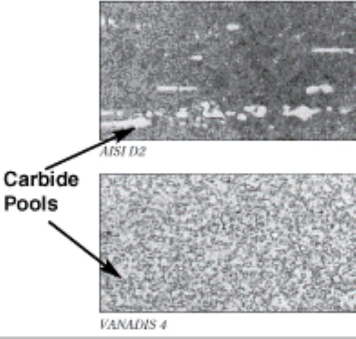

  • Use the right grinding wheel—Remember that when you grind tool steel sections such as D2, M4, and powdered metals, you actually are grinding small carbide pools (Fig. 1). Carbide is a very hard metal to cut. Use a wheel that breaks down and does not load up during the grinding process. Wheels that load up can cause excessive heat to build up in the die’s sections, resulting in softening, heat checking, or cracking of the die section or punch. Using flood coolant methods will help keep your die section as cool as possible. Think of your grinding wheel as millions of single-point cutting tools, like sand, held together by a bonding agent. Once the small granules of sand get dull, they must fall off the wheel. If they do not fall off, they will no longer cut smoothly and will begin to load up and burn the die section.
grind shear anglesThere are just a few of the basic maintenance items that need to be addressed. Create your own list based on your needs, but be sure you’re setting a true die maintenance program and not a die repair program.
Consult with your grinding provider to determine the best grinding wheel for your application. Keep in mind that there is no single miracle wheel that can be used for all tool steel and low-carbon applications.

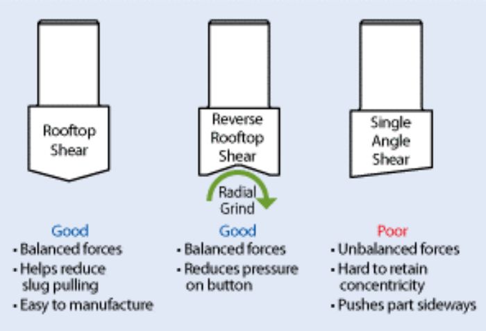

  • Grind the proper cutting shear. Angularity ground on the cutting sections helps to reduce the necessary cutting force and helps quiet down the die. The correct cutting shear also reduces the shock loading of the die and press, prolonging press and die life.
  • Grind shear angles so the cutting action is balanced. This will help to maintain punch-to-button alignment and prevent excessive shifting of the piece part (Fig. 2).

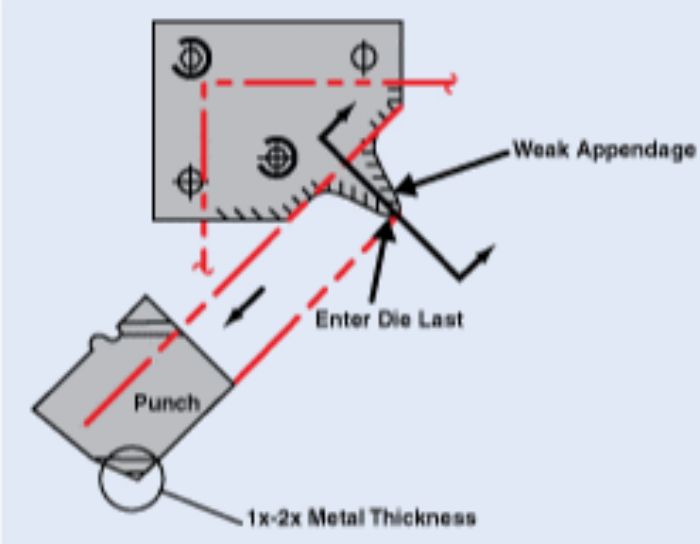

  • Grind your die section so that small, weak appendages enter the die last. This help prevent impact shocking and possible breakage of a small, weak cutting feature (Fig. 3).
