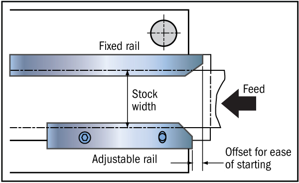

Extended guide rails with large lead-in angles assist press operators when starting the strip. Make one of the stock rails adjustable to compensate for any variation in strip width (Fig. 1). The first-hit position of the coil strip’s lead edge is critical for the first press stroke, to ensure that piercing punches do not cut partial holes in the lead edge. Use a positive stop, pitch notch or spring pin, rather than a sight stop.

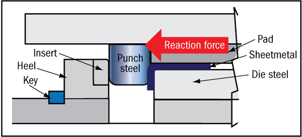

Unbalanced forming or cutting can result when starting the lead edge of the strip, which can tilt forming pads and stripper plates. This can be particularly problematic when stamping thick materials. Ensure that forming and cutting stations have heels to absorb side thrusts when stamping thick materials (Fig. 2).

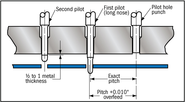

Often, the most misunderstood part of die setup is setting feed-release timing. The strip material may slide backwards after the feed releases the material and before the pilots have entered the pilot hole. To prevent this, make the first pilot with an undersized nose longer than the other pilots (Fig. 3). MF
