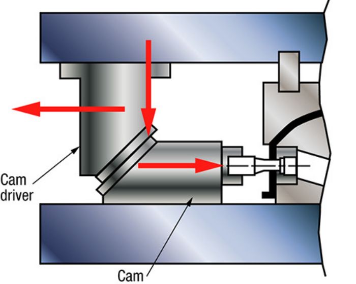

Fig2-Force vectors cam operationGiven precise die alignment and equal cutting clearance around the hole, the opposing horizontal forces balance out. A punch misaligned by 0.0015 in. would result in a horizontal force on one side of the punch of 503 lb.-force (0.25 tons) and 681 lb.-force (0.34 tons) on the other. Should the force differential be great enough, the punch point could deflect toward the lower-force side of the hole, worsening the misalignment condition.
If we replace the 3.1416-in.-circumference hole with a straight-line trim of equal length, the entire 592 lb.-force of force acts on one side of the punch and attempts to push the die component(s) side-ways. The die designer must understand the impact of horizontal forces acting on individual die components in order to control these forces in the die design.
Other Horizontal Forces
Horizontal forces exist in dies besides the one illustrated for cutting. Force vectors are present during right-angle bending, nonsymmetrical forming and drawing operations. Using cams also generates large side thrusts. Cams with 45-deg. driving angles (Fig. 2) produce horizontal forces equal to the vertical force acting on them.
The press also applies horizontal forces, especially when the ram is not parallel to the bed or guided properly in its gibs. In this case, side thrusts of very high magnitude act on die components and the die assembly. Dies that are somewhat self-aligning—draw dies, for example—will attempt to overcome this situation. Sometimes, larger guide pins and additional heel blocks are employed to move the ram into a parallel position. Unfortunately, the forces required to shift or guide the press ram into proper alignment likely are much greater than can be handled by the die-alignment components, causing deflection of these components.
