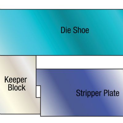

Fig. 1As the die begins to close, the upper stripper plate contacts the stock strip and any guide-rail lifters used to raise the stock strip above die level—usually to facilitate feeding over form stations. The stripper face pushes the stock strip down until it is held against the lower-die steel. The guide-rail lifter has over-traveled slightly to ensure the presence of a gap between the top and bottom surfaces of the lifter (Fig. 1).
As the press ram continues downward, the stripper plate and pressure pads for forming (if any) start to compress and build pressure. This is followed by cutting and forming as the ram continues toward bottom dead center (BDC) of its stroke. At BDC, the forming pads have bottomed out (but not the stripper), and any stencils in the die have penetrated the strip surface.

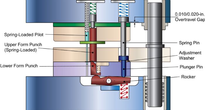

Fig. 2The use of cams, especially aerial cams, further complicates the timing sequence due to their travel distance, stripper-contact timing and increased travel distances of other components due to the vertical heights of the cams.

Small parts—for the electronics industry for example—almost always feature complex forms, and those forms generally have tight tolerance requirements. Forming at high speeds becomes more difficult with the need to always keep the stock strip straight throughout the tool—no lifting of the strip off of the die surface. This requires the use of form punches that raise from the bottom of the die and then return in order to allow feeding of the strip.
Fig. 2 shows a bottom-action form station. The upper spring-loaded form punch contacts the strip before the lower form raises. A rocker that pivots on a pin as well as a plunger pin activate the lower form punch. This pin has an adjustable washer under the head; washer thickness can be adjusted to suit the desired travel distance of the form and to facilitate springback compensation. A spring-loaded pin activates the plunger pin. Notice that this pin’s function is to provide a small amount of over-travel to accommodate small changes in shut-height variations that occur due to press setup, press speed and press temperatures.
Keep in mind that the amount of spring pressure required to form even simple, thin parts can be considerable. The best option: large springs with ample free length and preload. The die layout will be longer due to the need to make room for the larger springs and rocker motions, but smooth strip feeding and consistency of the forms will make the longer die assembly an asset, not a liability.
