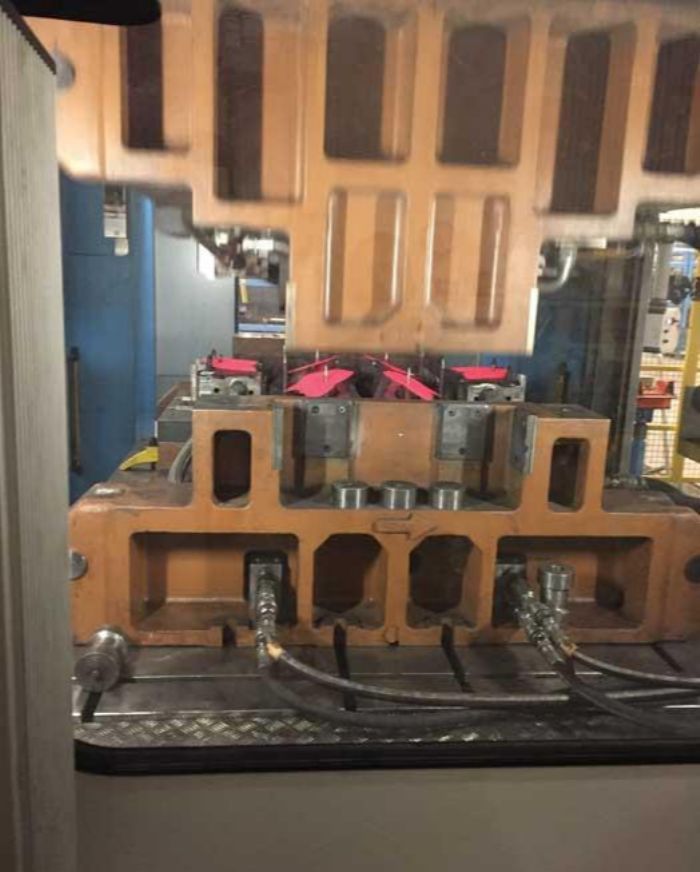

dies for hot stamping cantrailSeveral methods are used to control friction. The part may be crash-formed without pressure pads when part geometry allows the free flow of material into the die cavity during forming. This is possible if there is not too much surface contact between the blank and die.

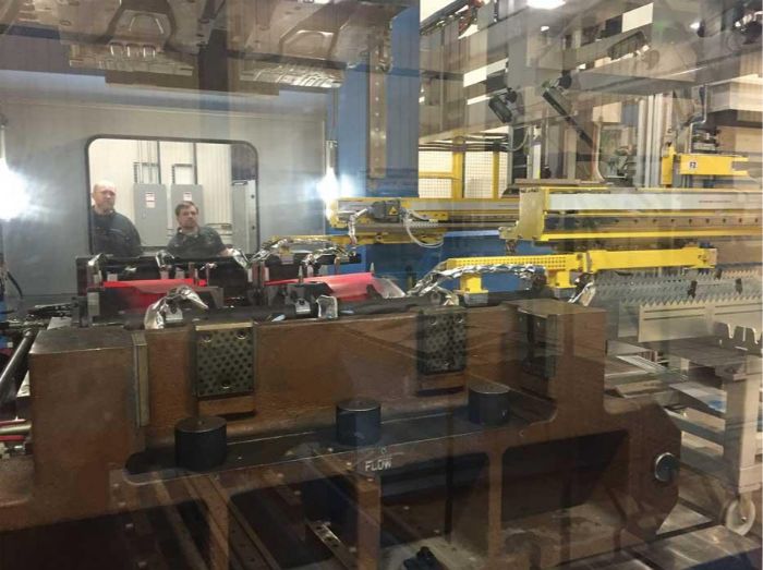

However, other methods are needed to control the part during forming to prevent its unintended lateral shifting, which would create the need for extra material addenda and post-forming trimming. Edge or pin gauges commonly are used to locate the blank during die loading. Stick pads may be used to grip or form the material in the center of the part. This is the opposite of most large cold stamping operations during which draw beads control material movement and ensure sufficient material stretch to remove loose metal and achieve a consistent form.
Because no lubrication is used and the material is very sticky, the primary forming challenges are friction-induced wrinkling of the material and keeping it hot enough to avoid hardening before the part is fully formed.
As soon as the heated material contacts the much colder die (typically below 200 deg. C), the heat starts transferring to the die, starting the rapid quench process. Consequently, forming should be done very quickly (usually in less than one second after the blank contacts the die) to ensure that the part remains pliable until it is fully formed. Minimizing the surface contact of the material being formed until the last part of the stroke will improve the process generally, and friction-caused thinning will be reduced.
While crash forming often will be the best die process, compression of flanges on the inside radii can cause wrinkling, with unacceptable distortion, or double metal after forming. In this case, a wrinkle control gapped pad is used to prevent excessive wrinkle height from forming. Nitrogen cylinders hold the pad apart to allow free metal flow into the cavity. These gap cylinders are compressed at the bottom of stroke to iron out the wrinkles before quenching.
dies-for-hot-stamping-hot-stamp-form-and-quench-diesTo further complicate the situation, the blank expands when it is heated and the part shrinks after it cools off during quench. This makes it more difficult to gauge and control the part during forming, since gauging has to accommodate the shrinkage without losing effectiveness and allowing the part to move. That would be counterproductive to any attempts to use developed trim lines to reduce the cost of secondary laser cutting operations for trimming edges and cutting holes.

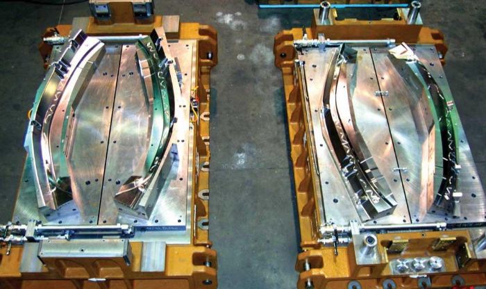

Effects on Die During Quenching
The quenching process rapidly cools the material. The temperature must drop at a rate in excess of 27 kelvins per second to change the austenitic microstructure into martensitic, without going through any ferritic or bainitic phases, which would prevent martensite formation. This requires sufficiently cool die surfaces (below 200 deg. C) that can absorb the heat from the part and transfer it to the water cooling channels that remove the heat from the die.
The die surface heat transfer coefficient depends on contact pressure and surface roughness. It is important to achieve uniform contact pressure, even on side walls, and to keep the tool smooth and clean. It is also important to have sufficient press tonnage. When debris, such as a material coating, accumulates, the die must be cleaned or the contact pressure will drop quickly. That will slow down the quench process to the point where quench rates are too slow, resulting in soft spots caused by bainite formations.
The same contact pressure deterioration can result from tool surface abrasion (typically male radii) that causes slower quenching. This increases cycle time and part cost. It also can cause part distortion by quenching unevenly, leaving residual stresses from uneven part shrinkage. That can contribute to inconsistent geometry after laser cutting or assembly. Quench rates also depend on proper distance of cooling channels from the surface and on thermal conductivity of the tool steel at elevated temperatures.
Last, the heat transfers into the water and is carried out of the tool. Water cooling typically occurs through drilled holes in the die. It is important to make sure that the water channels are matched to the facility’s water chiller capabilities (temperature, pressure, flow) so the tool uses all of the available chiller capacity to quench as quickly as possible.
It is also important to balance water flows between parallel cooling channels to maintain uniform quenching of the part, especially if the part geometry is sensitive to quench uniformity. Also, water flows must be turbulent to improve heat transfer capacity. High water pressure creates better cooling channel heat transfer coefficients and, therefore, more efficient heat transfer.

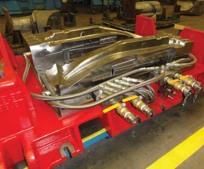

dies-for-hot-stamping-pillarsHot form and quench dies require more maintenance than conventional cold stamping dies because of the thermal expansion and contraction that takes place each press cycle. As the die heats up during quench, and then cools off during part unload, blank load, and part forming, heat checking occurs, which can cause tool cracks and water leaks. As a result, tool steels are generally H13 or better grade materials that can take the thermal shock as well as forming shock loads and abrasive materials.
Typically, water channels are cross-drilled into blocks that are assembled with O-ring seals. These tend to degrade over time and are replaced whenever tools are disassembled for maintenance and cleaning. Also, O-rings are exposed to heat damage between the surface and the water channel. Proper compression of O-rings is important to eliminate water leaks in the tools.
Tool steel cracks caused by thermal expansion, contraction, and heat checking usually occur between the surface and water channels. When excessive cracks are seen, a higher-quality H13 ESR variant tool steel may be warranted. Cracks can sometimes be repaired by welding.
When excessive die wear occurs, it may become necessary to replace the forming steels or to recut die surfaces. Water cooling channels make recutting more difficult, as it is important to maintain proper spacing from the die surface to maintain die strength and cracking resistance. Recuts generally are quite limited with hot form and quench tools, and they are difficult to achieve with deep-draw section side walls.
