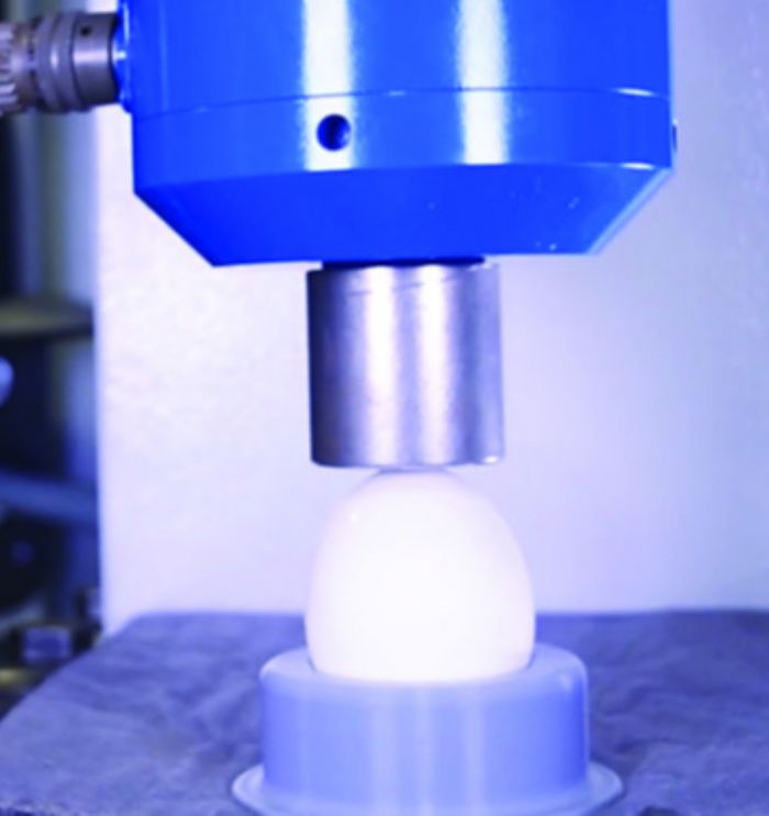

1-Servo-Electric-Press-Beckwood-EVOx-egg-forceMetalForming: How is a servo-electric press put together, and how does it work?
Josh Dixon: From an anatomy standpoint, a servo-electric press features a similar structure to that of a hydraulic press. In place of a hydraulic cylinder for generating force, a servo-electric press employs a roller-screw electromechanical actuator—a mechanical actuator driven by a servo motor. The servo motor replaces the motors, valves, pumps and related components typically found in hydraulic presses with an electric and mechanical drive train.
MF: How does this replacement affect performance?
JD: A servo-electric press features much tighter position and force control than can be achieved with a hydraulic press, offering programmable positional accuracy of ±0.0005 in. And, while mechanical presses excel at achieving the same position at the bottom of the stroke cycle-after-cycle, they don’t allow for a level of programmability where users can easily change it from tool-to-tool or part-to-part. Servo-electric presses maintain many of the same benefits of hydraulic presses, such as full tonnage throughout the stroke, extended dwell and programmable cycle profiles.

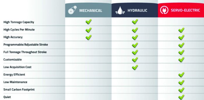

2-Servo-Electric-Press-ComparisonMF: Conversely, when are servo-electric presses not the ideal options?
JD: In some applications, hydraulic presses provide the better fit, such as the crossing of a certain tonnage or force threshold where servo-electric presses lose cost-competitiveness. Beckwood has built presses with multiple servo-electric actuators and motors grouped together and synchronized, which allow greater force generation than with a single actuator and motor. But at a certain point—six, eight or 10 actuators—the cost can't be justified.
