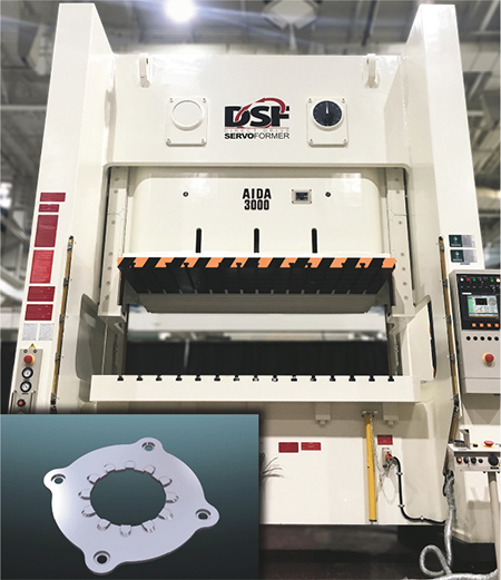

The second press on display, a DSF-N2-3000 300-ton, two-point straightside servo press (pictured), will anchor a progressive-die production line blanking near-fine parts. It will demonstrate how servo near-fine blanking via this technology can produce a 90-plus-percent burnished surface with a straight edge, exceeding the typical 70 to 80-percent burnished-edge requirement of many applications. The combination of this press’ accuracy and programmability can transition near-fine parts from a high-cost, labor-intensive machine process to a much more efficient, economical stamping process, presenting the opportunity to dramatically reduce the per piece cost, according to Aida officials. The production line is made possible through the cooperation of Portland Products, Inc., Portland, MI, which will take delivery of the press following FABTECH. Aida-America also is coordinating with Dallas Industries and Pax Products for this demonstration.
