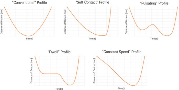

Although servomechanical metal forming presses provide a variety of servo-motion profiles, those most-often applied to improve material flow are soft contact, pulsating, dwelling and restriking (Fig. 1). Depending on the workpiece material and forming process, the effectiveness of each motion profile may vary. These motion profiles started to gain popularity as materials with lower formability and higher strength entered the market. Examples include advanced high-strength steels (AHSS) and certain aluminum alloys such as the 6XXX series.

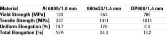

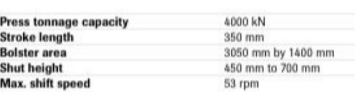

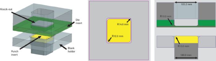

Servo Fig. 1To investigate how servo-motion profiles can help when forming these challenging materials, researchers conducted a set of drawing experiments using a 400-metric-ton servo press (Table 1). The experiments were conducted with a 100-mm square punch (Fig. 2), with a 900-kN-capacity load cell installed under the punch to measure forming loads. Tests were performed using 1.4-mm-thick Gen 3 (980-MPa tensile strength) and dual-phase steels, as well as 1-mm-thick Al 6005 (Table 2).

Servo Table 1The researchers performed their metal forming tests on 210-mm-dia. round blanks, drawn into 50-mm-square 40 mm deep for dual-phase steel and 50 mm deep for Gen3 steel and Al 6005. The holding force at the start of the forming stroke was set to 180 kN and a total of 3 g/m2 of lubricant was applied consistently on both sides of each blank. Draw depth: 40 mm for dual-phase steel and 50 mm for the Gen 3 steel and Al 6005. As a base line, they set forming speed to 20 rpm—approximately 270 mm/sec. or 245 mm/sec. at contact, depending on the draw depth. Later, they used motion profiles such as soft contact, pulsating, dwell and constant speed for comparison (Fig. 3).

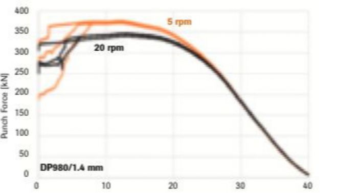

Servo Table 2Servo Fig 2The first parameter of interest: forming speed, or whether a drawing operation should be conducted quickly or slowly. While the common opinion among stampers is to reduce forming speed to improve drawability, results of the tests using the servo press were counterintuitive. For all materials tested, researchers consistently observed better results at 20 rpm (245 to 270 mm/sec.) rather than at 5 rpm (61 to 67 mm/sec.). A lower force measured when drawing at 20 rpm supports these results (Fig. 4). Nevertheless, only adjusting speed proved useful only when forming the Gen 3-steel cups 50 mm deep; while drawability increased in all cases, they still observed fractures at 20 rpm when forming DP980 40 mm deep, and Al 6005 50 mm deep.

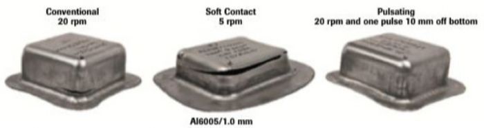

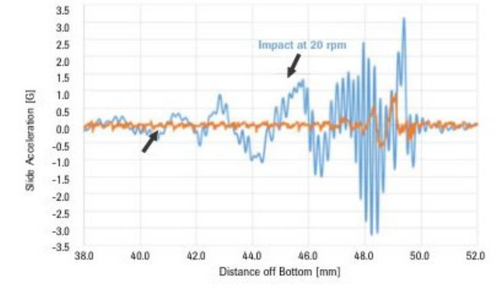

Servo Fig. 3Servo Fig. 4As an alternative, researchers investigated the use of a pulsating force profile (Fig. 3), designed with one pulse at 80 percent of the draw depth. This alternative method proved useful when drawing the Al 6005 cups (Fig. 5) but not DP980. Rather, to successfully form the DP980 cups, a dwell profile worked best, using a 0.5-sec. dwell at 50 percent of the draw depth. Finally, to improve the drawing process on the Gen 3 steel, a constant-speed profile proved ideal, along with the addition of a soft contact to reduce vibration on the tools and the press (Fig. 6).

Servo Fig. 6To keep the production rate as high as possible using servo-motion profiles, it is important to use a servo press with low inertia and capable of quick accelerations and decelerations. In addition, some of the proposed motion profiles require a press with a special lubrication system that allows for dwell time under certain loads.
