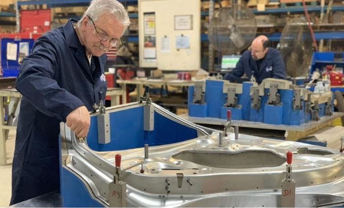

2-second-gen-michigan-stamper-prototype-PTMPerfect the part. One goal of prototyping is to prove out the part. PTM might stamp three or four versions of a part and before the customers buyoff depending on size and complexity, according to Russell-Kuhr.
“While you’re creating prototypes, you learn a lot about that part,” she says. “You learn about the metal, the properties and the problems that you may have. We work with customers at the prototype stages to understand the part’s purpose and function so that we provide the customer a product that’s repeatable in production.”
“It’s costly to make engineering changes at the production stage,” adds Steve Kuhr, director of business development, estimating and engineering., and Donna’s husband.

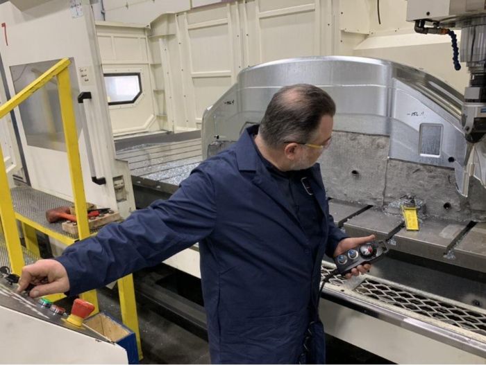

4-second-gen-michigan-stamper-prototype-PTMDevelop cost-sensitive prototype tooling. It’s essential at the prototype stage to be able to design and build tooling to meet customer needs. At the same time, much is learned from the prototype tooling that can benefit the production tooling. Most cost avoidances can be made at this stage in prototype to develop lessons learned and carry over to production tooling and processes. The benefits of prototyping can outweigh high engineering costs of production tool changes.
“When a customer comes to us with a low-volume part, we can’t be competitive with production tooling costs,” Kuhr says. “Our advantage is that we know production and prototype and how to design and produce robust prototype tools at a lower cost. Then we take it back to the secondary form stations. We form the geometry characteristics into the part through a series of stamping stations.”
The largest press at PTM: a 2000-ton-capacity model.
“We’re forming fenders, doors, hoods and Class A surfaces with that press,” Kuhr says. “We provide assemblies on closures as well as highly complex assemblies such as front-end and rear rails.”
Normally it takes only two or three hits to form a door or fender, with a couple of laser trims in between. But each part is unique, and the number of stations varies for each prototype process. One operation had 28 forming stations after it was laser-blanked to become a finalized part.
On occasion prototype parts need hand qualifying, but simulation software mitigates that.

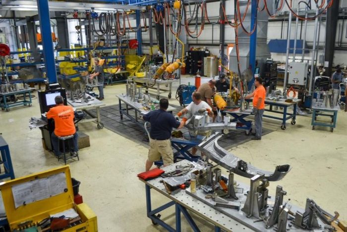

Small prototypes. The small-prototype process starts similarly to the large prototypes, with some significant differences.
“It’s similar to our large-prototype process in that we create a developed blank which is laser-cut,” Kuhr says. “Then we use a series of line dies to form the part. But we mirror our stamping production process more closely throughout our small-prototype process.
“Think of a progressive die, and each station is pulled out and set in a series of small presses to form the part to its specifications,” he adds. “We perform each of the operations in a number of small, single presses. This produces parts with characteristics similar to mass production.”

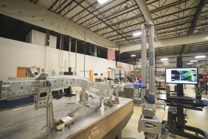

5-second-gen-michigan-stamper-prototype-PTM“We take on those low-volume jobs—a few hundred parts or more and before you know it, we’re quoting large-volume production,” Russell-Kuhr says. “That’s kind of how we migrated prototyping into production and it made a natural fit for our business model growth.”
About half of the jobs for small-part prototype programs at PTM go into production tooling and production facilities; however, once the large prototypes are perfected, the OEMs usually perform production.
“We might prototype a door for an OEM, but its own production facility will run production and our work ends at the prototype stage,” Kuhr says. “Automakers like to control their Class A process, especially outer skins.”
