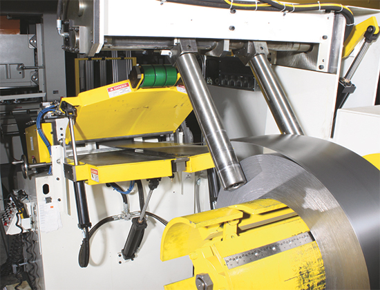

Coil handling for the new line also incorporates automated material feeding into the press via a servo-driven roll feed. Where traditional systems employ hand cranks to raise and lower the feed’s mounting cabinet during setup to achieve proper passline height, this line features motorized adjustment and encoders that allow for storage of the correct passline height in a job recipe.
Further, a tool-less press attachment bracket is another time- and labor-saving innovation supplied by Coe. On standard feed-cabinet designs, the operator manually releases bolts that secure the feed cabinet to the press frame, a step requiring the operator to walk completely around the press twice during each setup—once to release and again to retighten. The tool-less system on Miller’s line eliminates that step. Also, the air cylinder that automatically raises and lowers the upper feed roll and applies downward force to hold material must be set at the correct pressure for each setup. This is one more parameter stored in the feed line’s job-recipe control, and that eliminates time needed for operator adjustment of a manual air regulator.
In addition to the stored parameters, the coil-handling and feed system features PLC controls and sensors monitoring the status of the line and its components. The controls prevent typical mistakes seen during setup and operation, preventing them from interrupting efficient operation, whether in setup or production. These mistake-proofing options, selected by Miller’s Adam Utecht and Jim Dimpf, prevent operators from wasting time correcting typical setup errors.

A coil support (located on the right in this photo) has a series of metallic side bars that allow it to shift inside the press window during die changes, then be extended to support strip and eliminate sagging as the strip feeds into the press.
