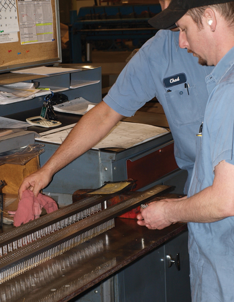

Ferguson press operators prepare a tool set loaded with hundreds of perforating punches, aligned in rows and staggered to control press tonnage. |
