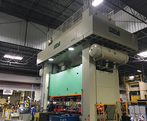

Stanco’s Jeff McMillin is shown operating the Seyi SEL2-1100. |
