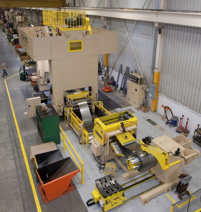

It took two weeks to get a replacement part, and a few more weeks to complete the repair,” Carson recalls. Forced to outsource production on those eight large dies for such a long period of time, company management decided to take a closer look at adding a new press to the plant’s arsenal. After much discussion and careful planning, Carson and the production team welcomed, late in 2019, a new press line into the facility. Anchored by a Stamtec 880-ton eccentric-geared mechanical press, the line also features a 51-in.-capacity uncoiler/straightener combo, servo feeder, 10-ton-capacity coil car, 118-in.-long loop table and Link Electric’s state-of-the-art OmniLink 5100 APC automation press control, complete with Link’s LinkNet 3 software for shop-floor monitoring and data collection.“

Link Systems Stamtec press EatonIn the several months since commissioning its new press—complete with a new concrete foundation that required excavating 60 ft. deep to take an underground creek out of play—Carson and his team have moved all eight of the large dies used to stamp safety-switch cabinets off of the 600-ton press.
“We still use that 600-ton press, but for less-critical and lower-tonnage work on smaller parts,” Carson says. “Now, with the added capacity and larger 144-in. bed on the Stamtec, as well as the 51-in. coil line (the 600-ton press runs coil from a 36-in. coil line), we can look at bringing in even larger dies. For our largest switches, we still have to form those case parts on a press brake.”

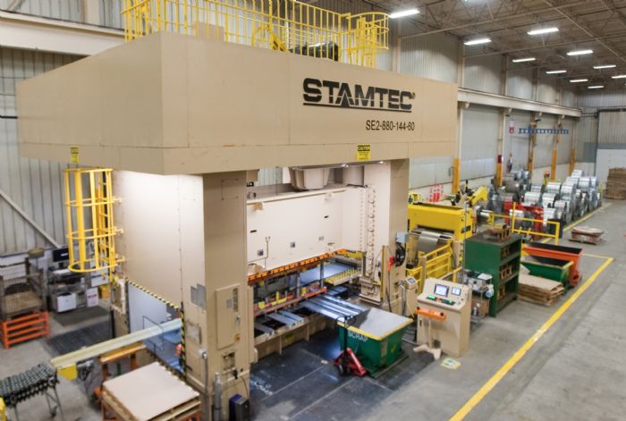

Eaton Stamtec pressComparing part quality from the old 600-ton press to the parts coming off of the new Stamtec, “there is no comparison,” Carson says. “To ensure that we were meeting dimensional tolerances, to help with assembling the cases after stamping, we used to have to shim the dies quite a bit on the old 600-ton press. Now, the precision and repeatability of the new press has eliminated any need for shimming.
“In addition,” he continues, “one of those eight dies we ran on the 600-ton press would typically exhibit uneven wear after several part runs, likely due to uneven loading across the bed. With the new press and its inherent precision, that problem, too, has gone away.”
