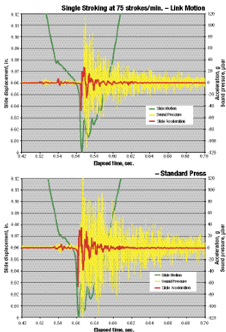

These graphs track sound pressure, slide motion and acceleration for 80-ton presses
Fig. 2—These graphs track sound pressure, slide motion and acceleration for 80-ton presses blanking at 75 strokes/min. Note the reduction in sound with a link-motion press (top) as compared to a standard crank-motion press (bottom).

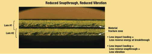

Reducing impact velocity, as stated earlier, also will reduce the negative effects of snapthrough and subsequent vibration. In blanking or piercing, when material fractures and the punch breaks through, energy almost instantaneously releases into the part, tooling and press. This can lead to premature punch failure and press damage. Broken bolts, cracked guards and similar damage indicate excessive vibration, and any efforts to reduce snapthrough and vibration, including reducing slide velocity, will have positive results (see Fig. 1). In addition, reducing slide velocity at the point where stripper plates or draw rings contact the workpiece material minimizes bouncing and produces more consistent forming results.

Finally, noise reduction also is a benefit of reducing slide velocity. Fig. 2 compares noise levels during blanking on two 80-ton presses, one with standard crank motion and one with link motion.
