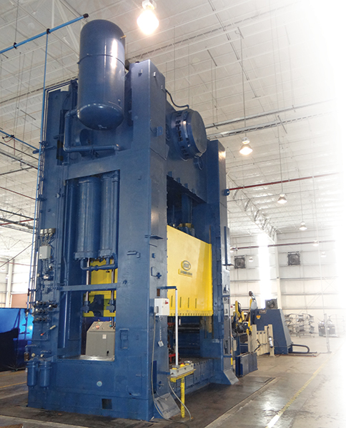

“We saw a pronounced need for bigger presses in Mexico,” says Schwochow, “for applications such as truck-cab walls and frame rails. Some parts that we have been stamping in Canada and transporting down to Mexico now run on the Danly, and we’ve brought back some outsourced dies that had been running in nearby Mexican pressrooms.”
This Could be the Start of Something Big
Mercury’s management team in Canada oversaw the purchase and rebuild of the 1000-ton press, along with a rebuilt 60-in.-wide-capacity feed line with 7.5-hp motor and five-roll straightener. The press rebuild, performed by Excel Machinery, St. Catharines, Ontario, Canada, included a clutch/brake overhaul, new counterbalance rods and seals, rebuilt slide overloads, a crown rebuild, upgraded controls and the addition of light curtains.

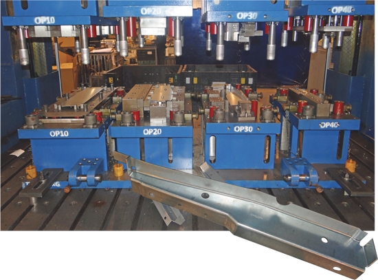

A four-station line-die setup on the 1000-ton press stamps truck-frame cross members, one of several previously outsourced jobs that Mercury Products has brought back inhouse following its new (used) press acquisition.
