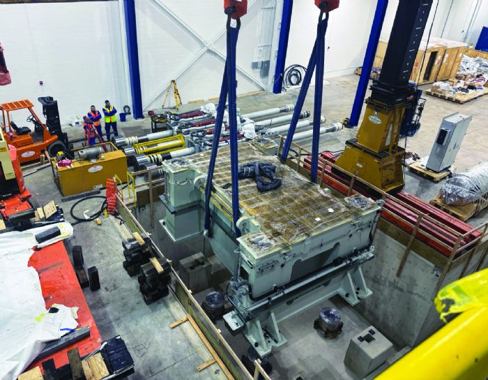

Schuler recently completed a 10,000-sq.-ft. addition, the result of a new program earned in 2023 that generated the need for an additional 5000-ton press (manufactured in Brazil at Prensas Schuler), along with a new bending cell and automation. Schuler took delivery of the new press early in 2025 and expects it to be in production by Q2 of 2025. Ronda Dr.: 57,600 sq. ft. The facility also houses a BLM tube-bending machine, a horn bender, Nachi robots, an assembly cell and quality lab. |

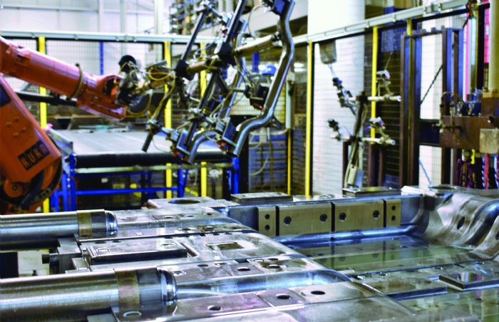

Describing the hydroforming process, Brown notes that the process parameters critical to success are pressure inside of the tube and the press tonnage required.
“After the tube is loaded into the press, the ram indexes down to a set position in relation to top or bottom dead center (BDC),” he says. “Then we fill the tube with water, monitoring to ensure that we have a sufficient flow of water. Then the ram begins to close while we close off the tube ends with sealing cones and create a closed chamber. At BDC, we build tonnage in the die, intensify the water pressure inside of the tube, and then perform any hole piercing that is required. We then release the water pressure, retract the piercing and sealing cylinders, and open the press. Cycle time averages in the 25 to 40-sec. range. All of these actions have a parameter-tolerance window, so that the process aborts if any parameter falls out of tolerance.”

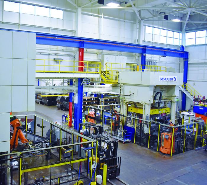

Schuler’s hydroforming operations comprise a 40,500-sq.-ft. facility on Commerce Dr. (including a newly completed 10,000-sq.-ft. addition) housing with four presses, along with an array of tube-bending machines; and a 57,600-sq. ft. facility nearby on Ronda Dr., with robot-tended tube benders, a pair of Trumpf five-axis laser-cutting cells, assembly cells and a quality lab. Its engineers provide customers with extensive expertise in forming parts from aluminum and steel grades, including advanced high-strength dual-phase steels.
Schuler launched its North American hydroforming operations in 2000. It now operates from two facilities in Canton, MI:
