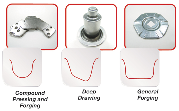

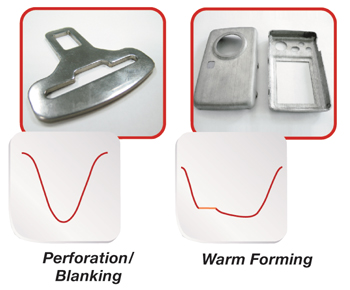

Shown are examples of stroke profiles and parts that can be achieved with a servo press.

Regardless of drive type, servo presses will run from a proprietary control designed to allow for the wide variety of stroke and slide-movement profiles possible, while supplying full working energy even at low speeds. Unique profiles can be created by the user; each profile can include:
• Cycle
• Swing
• Multipass
• Simulation of link motion
• Compound pressing and forging
• Deep drawing and general forming
• Perforation/blanking
• Warm forming
