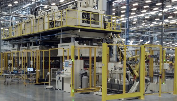

Proper Approach for New-Press Automation
Hydraulic Presses-Greenerd-Press-LineA partnership is vital. As providers, we must understand a metal former’s goals and then offer press solutions that not only meet, but often exceed, expectations. Working side-by-side as a partner enables us to become an extension of the metal former in a sense—sharing/owning the same stated goals.
The challenge: Identify the ‘right size’ for the automation solution—addressing today’s and tomorrow’s production needs while keeping within the project budget. This makes tailoring automation offerings to fit a range of applications very important. This holds true for everything from basic hydraulic-press automation, such as electrically integrating a material feeder with the press, to large multi-press, multi-robotic, autonomous workcells.
For example, we recently were approached to build a rotary automated cell. The metal former’s stated goal: Purchase three separate presses then connect them with the framework and subsystems once onsite. We worked with the metal former to improve the press-line concepts and deliver all three press functions in a simplified working cell with a smaller footprint. After delivery and install, the metal former noted that cost analysis revealed better value in having a single source for design and build of the complete integrated solution. Doing so had simplified the operational side of capital-equipment purchases, which reduced the metal former’s headaches and costs.

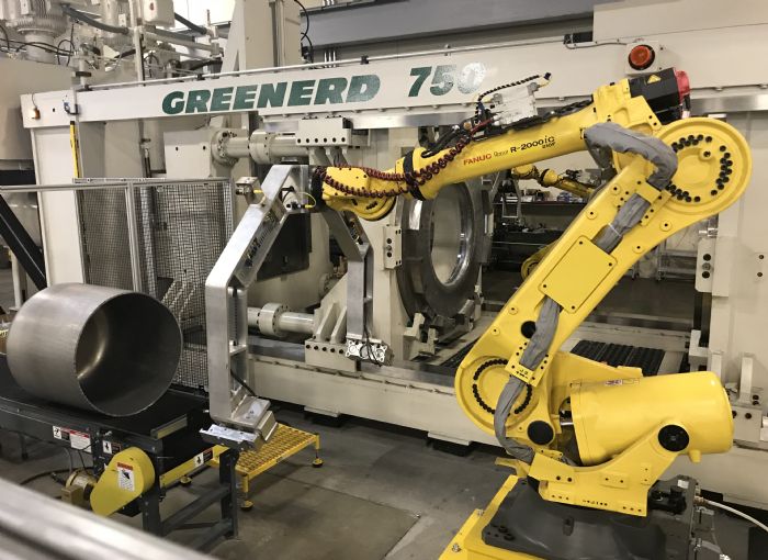

Opportunities exist for productive automation well beyond the hydraulic press itself. For example, we worked with a manufacturer to automate the repetitive loading and unloading of one of its presses, and engineered a solution to integrate seamlessly into the existing press and work within limited floor space. However, the return on investment (ROI) fell short of the manufacturer's goals, so it reluctantly considered canceling the project.
Knowing that this manufacturer needed the automation in order to retain its product line, we asked if we could examine processes located upstream and downstream from the press. Careful study yielded solutions. Parts could be reoriented upstream to reduce transfer times. Also, one downstream process could be eliminated by expanding automation at the press to directly feed the next process.
Exploring upstream and downstream options resulted in elimination of product transfer and handling bins, and reduction in part-transfer times and overall floor space. The solutions exceeded expectations and reduced ROI times to within required limits. The manufacturer ended up saving the product line and increased margins on each piece.
