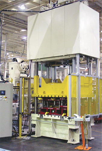

Monolithic
  • High stiffness and torsional rigidity for improved off-center-loading capability and low deflection
  • Precision machining of frame due to lack of build-up tolerances associated with machining multiple frame components separately
  • Adjustable eight-point gib or temperature-compensated guiding
  • Low field-assembly costs because of single-piece frame
  • Accessibility to all four press sides for material flow, die change and maintenance
  • Suitable for single frame weights to 80 tons
  • Suitable for presses in capacities to 2500 tons, depending on bed size
  • Practical bed sizes as large as 120 by 96 in., depending on tonnage
  • Suitable for single-acting, single-acting-with-cushion, double-acting or triple-acting metalforming applications
  • Accommodates front-to-back or left-to-right rolling bolsters

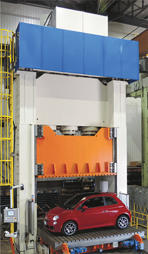

Housing
  • Frame components (bed, slide, crosshead and housings) are pre-stressed together with tie rods and pre-stressing nuts
  • Suitable for individual frame-component weights to 150 tons (depending on the press manufacturer’s capabilities)
  • Allows for larger bed sizes, in excess of 300 in. left-to-right
  • Can incorporate front-to-back or left-to-right rolling bolsters
  • Ability to dismantle frame allows for large presses to be shipped in smaller and lighter pieces

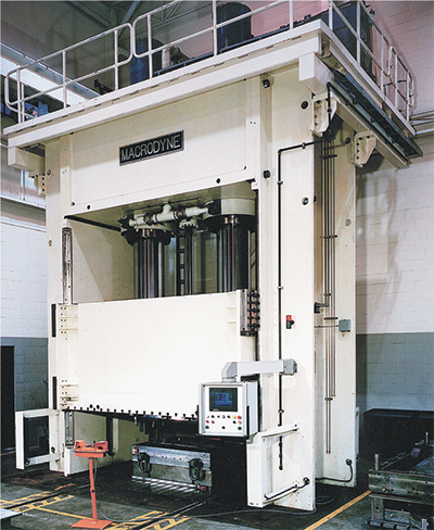

Column
  • Limited off-center-loading capability
  • Generally not ideal for heated applications unless platen-die interfaces are thoroughly insulated
  • Features bushing-type (not adjustable) guiding

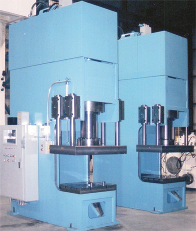

C- or Gap-Frame
  • Generally used for lower-tonnage applications (less than 1000 tons and typically below 300 tons)
  • Accessibility to the die space from three sides of the press
  • Available for single-acting or single-acting-with-cushion metalforming applications
  • May be supplied with adjustable, eight-point gib guiding or two- or four-post-style guiding.

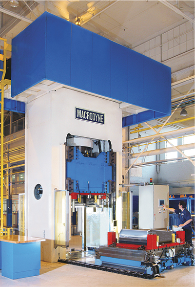

Multi-Frame
  • Suitable for high tonnages (to 20,000 tons) with small bed sizes (to 120 by 60 in.)
  • Provides a compact design for high-tonnage presses
  • Has front and back access (no side access)
  • Can incorporate front-to-back shuttles or rolling bolsters
  • Typically suitable for single-acting applications only

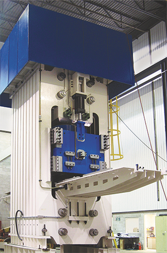

Side-Slab
  • Frame components (bed, slide, crosshead and side slabs) are pre-stressed together with pre-stressing studs and nuts
  • Features adjustable eight-point gib or temperature-compensated guiding
  • Limited side-opening capability
  • Allows for larger bed sizes, to 240 in. left-to-right
  • Can incorporate a rolling bolster (front-to-back only)
