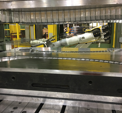

A hot stamping press requires a relatively long stroke and rapid closing of the die to minimize the time in air for the heated blank, a critical parameter for the hot stamping process.
This makes servohydraulic presses well-suited for such applications, report officials from AP&T North America, which supplied machines for Urgent Design & Manufacturing’s automated hot stamping cell and has developed a new generation of servohydraulic presses. Stampers reportedly can achieve significant energy savings during quenching and part handling when the slide stands still, as the servo motors in such servohydraulic presses operate at almost 0 rpm.
Also, hot stamping tooling normally contains high-force gas springs, which require a gas-spring-discharge function on the press to prevent hydraulic-system damage. This function allows the press to start the return stroke at a low speed, enabling the gas springs to push the slide up before the fast return stroke begins. Presses equipped with this function reportedly exhibit reduced cycle times as compared to conventional hydraulic presses.
