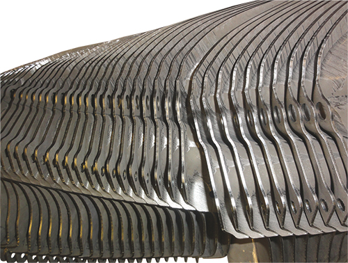

- Deep cross-sectional shapes can be formed due to elongation of 25 to 50 percent during forming, allowing a reduction of the number of stampings in the vehicle and associated assembly cost.
Heavy-gauge, high-strength structures can be produced using hot-forming. |

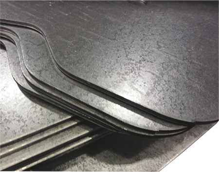

Locator holes in blanks help control the part during forming and in many cases, eliminate the need to laser trim.

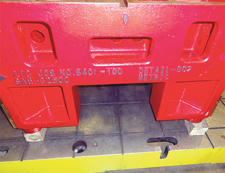

However, Austin also points out that with hot forming, tooling costs can be reduced by as much as 30 to 40 percent. Why? “With cold stamping of AHSS, you have a line of presses or a transfer press, and you’re building three to five dies that may have to be machined multiple times to make the part due to springback variation,” he says. “Furthermore, the stamper may still need to re-machine the dies several times over their life-cycle. With hot forming, you build one die—a more expensive die—but because of the material’s near-zero springback, the die doesn’t have to be remachined. It’s a very efficient process in terms of tooling.
“Take for example,” continues Austin, “a transfer press producing medium-sized parts. Every set of tools could cost as much as $1 million, and you might buy 40 sets of tools over the life of that press. If by hot forming you can cut the cost of tooling by nearly half for every set of tools, then guess what? You’ve just bought a couple of presses.”

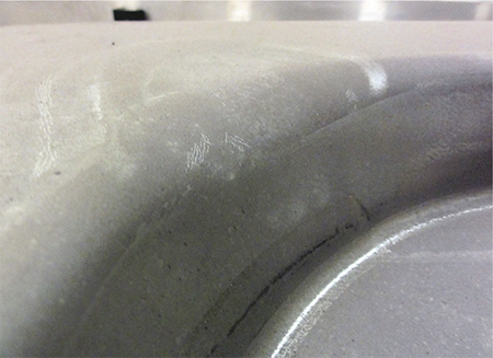

Hot-form dies resist deflection and uneven quench pressure. |
He continues: “For low-volume production, a pair of single-cavity RH/LH tools often is used, sometimes in the same die set. If the press is large, there may be other parts loaded in the same die set. Using the same coil of material within a die ensures that any variation in material gauge impacts all parts, maintaining balanced contract pressures. That is, unless special press or die-cushion provisions are used to maintain even contact pressure, which helps to maintain uniformity and minimize quench time.
Austin offers additional advice for higher-volume production. “Multiple-cavity tools often provide two pairs of parts per stroke,” he says. “For door-impact beams, for example, it is common to produce four beams per stroke. In some cases, especially now that smaller reinforcements are commonly made with the direct PHS process, six or eight parts are made for each press stroke. Limitations in furnace and automation handling must be accounted for when using smaller blanks. In some cases, connecting blanks together helps heat and move the blanks into the press, and the connection is removed during laser cutting.”
