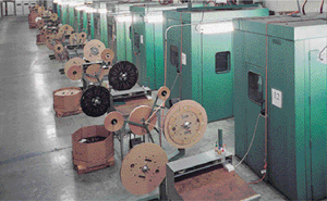

A look down press row at one of three Composidie stamping plants. The 25,000-sq.-ft. shop runs 26 Bruderer high-speed presses.
When the plant manager tells you that his contract high-speed stamping company enjoyed its best-ever year in 2000, and then in two years lost more than 50 percent of its business, you have to think that the resulting article might be short and not so sweet. But as startling as that scenario sounds, and that is precisely what happened to the stamping operation of Composidie Inc., Apollo, PA, the story of its recovery is even more startling.
In the late 1990s through 2000, the three sister stamping plants of Composidie hummed to the tune of more than 50 high-speed Bruderer presses. We’re talking contracts calling for weekly production of 50 million connectors, jacks, terminals and similar products for telecommunications, electronics and other customers. However, at the turn of the century many of these customers took much of their high-volume work overseas. To stay alive, Composidie management turned its sights toward morphing the company into a specialist in shorter-run lower-volume work—jobs requiring as few as 20,000 parts per year, even though the firm still produces some parts with annual volumes in the millions. This evolution means more attention to contract management, inventory control and scheduling, as well as quick-die-change techniques.
“We went from running 50 dies to make 2 billion parts per year to working with 400 dies,” says Andy Flock, plant manager, during our tour of one of the firm’s stamping facilities, a 25,000-sq.-ft. building housing 26 high-speed Bruderer presses. “During the recovery period beginning in 2002, we had to learn how to better manage the increase in the number of jobs we run, as well as the added complexity of die-maintenance scheduling and the processes used to change out dies.”

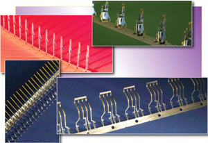

Samples of the parts stamped and plated at Composidie, which processes a variety of alloys—beryllium copper, brass, bronze, stainless steel and aluminum—from strip 0.210 to 3.5 in. wide and 0.0025 to 0.310 in. thick.
The firm serves a core customer base of 10 to 15 companies as a Tier Two supplier, and has another 50 customers or so that place orders a few times a year. For its core customer base, it runs some 200 dies, stamping a variety of alloys—beryllium copper, brass, bronze, stainless steel and aluminum—processed from strip 0.210 to 3.5 in. wide and 0.0025 to 0.310 in. thick.
