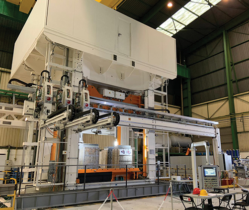

The turnkey hot stamping line supplied to VW Kassel includes two parallel roller furnaces, three freely programmable loading feeders and an end-of-line solution that allows fully automatic or manual racking. Three loading feeders and a die-control drive system enable each blank exiting the furnace to be moved independently to the die instead of in groups. This setup results in smaller-sized furnaces, given that after leaving the oven the pieces are separated to be stamped. With this automation and a powerful hydraulic unit, the press can attain high processing speeds, according to company officials.
Fagor Arrasate earned this project after the installation of two productive hot stamping lines at another of the company’s plants, according to Fagor Arrasate officials. These lines, fully automated in both loading of forms and stacking of parts, also contain parallel ovens for heating blanks. A Fagor LR3-120 feeder in each line allows rapid transportation of the hot blanks to the die. A shuttle and three Kuka robots automatically place the newly stamped parts in the stacking containers. An additional output belt allows for part inspection.
